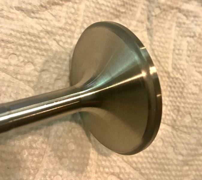

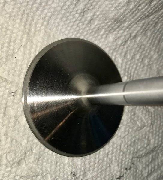

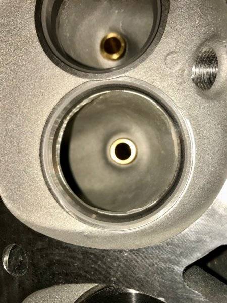

Had a Stealth Head on a 496. When I took it off, and was cleaning the valves, I noticed one ex valve was letting light thru from the chamber side. Re faced the valve, touched up the seat, and still not sealing all the way around the valve.
I can see light in the ex port when shining a flaslite from the chamber side. Any ideas on what could be wrong here? Only on #3 ex valve
I would check the valve for any runout and use some prussian blue (or a Sharpie) on the seat after you lap it to see how it's seating.

Might go through the trouble of looking over the seat itself, Gary.
Is it in straight, or maybe was galled when installed? Steel seats in aluminum have to be put in right, before they will seal up right.

Thanks! Yea the local machine shop worked on it, and opened up the seat with a Quik Way machine, now the valve is sealing way out on the edge of the seat. Not too happy with them. Found a guy in Golden who has been doing HEADS ONLY in his shop behind his house, and sounds like he knows what he's doing. 30 plus years at it. LOL. He's going to replace the seat, and surface the heads. I'll let you know how that works out. He's 3 weeks behind, so that says something right there. Very much in demand!

Yup, guide, seat, or both, is off. Takes the right method, especially on the cutting, to keep things in line. Good luck on it!
Pretty much all typical performance work on heads will put the valve seat/valve interface near or at the outer edge of the valve.
As long as there is an adequate width of contact between the valve and seat for the application, it should be fine.
.060” wide would be fine on a street/strip type of application.

Seat concentricity to the Valve Guide ?
I dunno why anyone would have to replace the seat itself ? Why not just re-machine the Valve Seat Angles in the seat where-ever it's sitting, and make them concentric to the V/Guide itself (within a couple of ten-thousands), and re-grind the Valve the same(within a couple of tenths)

Well I will take it to the head expert and see what he wants to do. The first shop tried to regrind the seat, but I don't think he really knew what he was doing. That didn't work. When I left, he started to bore out the seat without my permission. I realized he was incompetent to replace the seat, so I took the head and left. Now I found a guy that knows what he's doing, 30 years experience. The first guy was pretty young, inexperienced.

I think I posted before about Stealth heads and leaking seats. A few exhaust seats leaked where there was a chunk of material under them when pressed in. Not only had a leak but the concentricty had to be off as well. The shop had to cut the seats out and had a hard time finding ones to fit.

Well that makes sense. I will check the other head today for leaks. This motor had leakage past the rings, and at least 1 valve seat so far. This motor has more leaks than the White House! Ha!

One test I did on my stealths when I bough them was to fill the ports with carb cleaner then letting them sit to see if the valves leaked.
