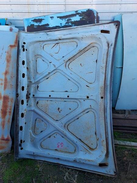

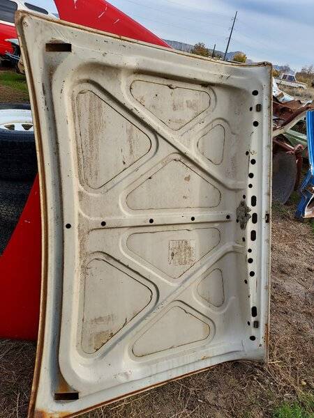

I just went through as I have 2 of each the 63 and 65 Plymouth lids. They are the same size and shape. The under structures have different holes and as stated the 65 has different trim holes.
Are the decklid mounts the same and in the same places between 63 & 65? Or is it just appearance changes (which I don't care about)?
Chuck
They are the same. Just some different holes.
Yeah, I found a 65 lid, just waiting on a shipping quote from TX to FL. Thanks for the pics, that helps a lot.
