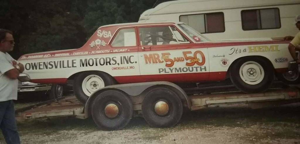

Ive been looking and reading about steel wheels for a couple weeks. Still confused... the early look like later or I really can't tell.. these in the front have an extra hole .. rear doesnt..someone please tell what wheels i should be looking for in this pic....
Thanks in advance. I'm still learning
Pic comes from vintage b body Mopar drag photos facebook
The wheels on the car, in photo, are the same, and they are "late" - 1970's wheels. Note the 9" button nub circle.
Pre 67 wheels used the 10" button nub circle. pre 66's "usually have 5 'guide' holes between the lug holes.
Came in 5, 5.5, 6 ,6.5" widths.
