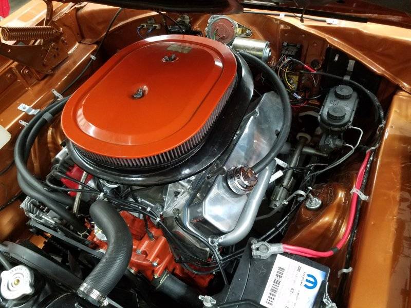

By the way, this is in my freshly restored 69 Bee. Firm feel kit welded on, seams welded, blasted, and painted. I'm just sick to my stomach at the moment.

I can understand.....but the only easy fix I can think of is to drill it for an insert. If the engine is in the car, that will make things hard to do if that's even possible.
The outer one?
If it's the outer one, might be able to fix it with the engine in place but can't see doing it with the steering box being in place. Heck, the box probably should come out for any of them....

Oh yeah, in the car and done. Was done anyway.
