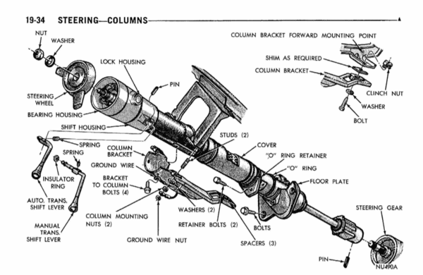

Hi, there are plastic spacers on the mounting assembly of the column bracket to the upper support. These were in bad shape. What are the spacers for? Getting into the last gear setting (1) is a bit off and I want to improve this and wonder if there is a geometry issue or possible damage tot he column. Has anyone set up their steering column that can add any advice?
I think those just give you an "adjustment sliding area" but do lower column about 1/4"....what the heck, buy new ones regardless, they're lime $2 each. That "might" affect getting into "low 1" on a column shift. I "think" there's a tube-thing (shift collar?) in the engine compartment where the column pokes through that has an arm on it that rotates as you change gears and a bushing in the end of that arm that cojld wear. I'm guessing a little, but I have something like that on my floor shift column for the "shifter interlock anti-theft" mechanism. I may have skme column parts for you too if needed.
Thanks Purple for responding! I am learning a lot as I dig into this car project. I just learned that these are break away mounts and are actually designed to help the column collapse in the event of an accident. So they not only shim as you stated by ~1/4 but are designed to break loose! I am taking out the washers and replacing with the correct parts. I will look into the engine compartment side more and see if I can figure out the collar thing you were talking about. I also am replacing the Z-Bar bushings and will clean and lube the linkages........
the plastic spacers are a safety feature that allows the column to slide down if your chest hits it in a crash
Yup but interestingly enough they are not included in the exploded view above! Nor is there ANY indication of this in the verbage WTF?
