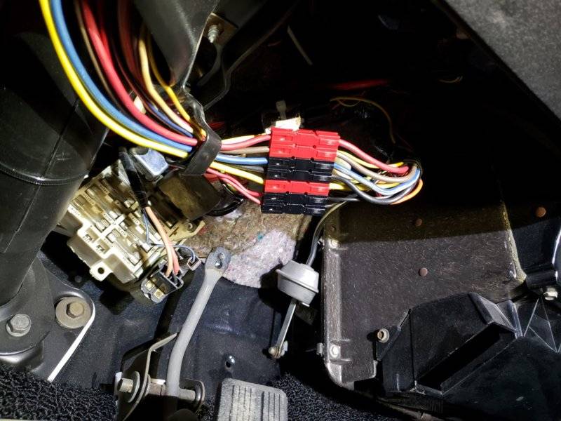

The original Molex style connectors used in that application can’t handle the real world current load on some of the ignition switch wires. They will burn again should you locate originals. While I try to use original style connectors where ever possible, I use Anderson Powerploe connectors for the ignition switch disconnect.

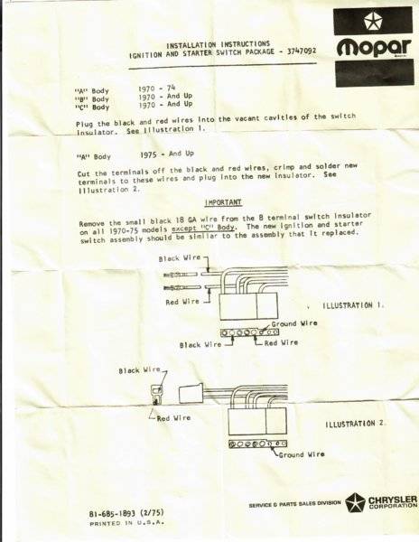

Later factory replacement switches came with extended black and red leads, Packard style connectors, and instructions to by-pass the Molex connectors altogether for those high current leads.
Thank You all for the reply. I had though about bypassing the two wires. Might be an option. I'd still like to have the originals because the connector is pretty well trashed.
This mod alone reduced the measured voltage drop between the battery positive and the alternator field ignition 1 feed connector, when running, by a full volt. The Molex connector it replaced was in pretty good shape by appearance, slight discolor near the red wire connector, but ran very warm to the touch and clearly had built up some serious resistance. These AP connectors are rated at 45 amps each.
