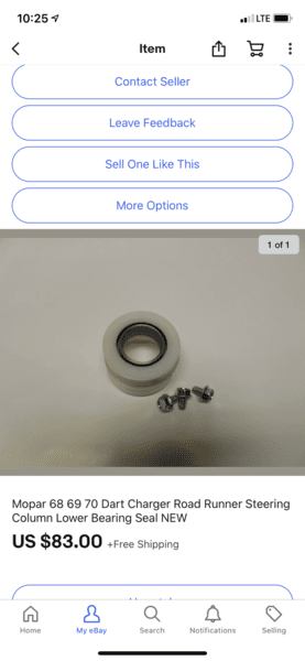

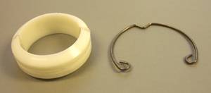

10-4. This is the lower bearing I bought. My column currently doesn’t have one. Does this go in the inner tube or outer? haven’t received it yet.
that goes in the outer tube and the steering shaft through it. If you have an inner tube it fits in the recess in the back of the outer plastic bearing holder.
That bearing goes at the bottom of the large outer tube.

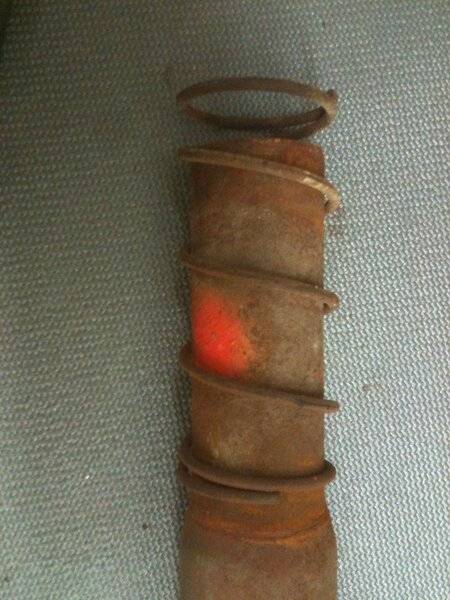

On my '69 that inner tube retains a large spring at the bottom and a collar at the top. And IIRC is what centers the top housings.

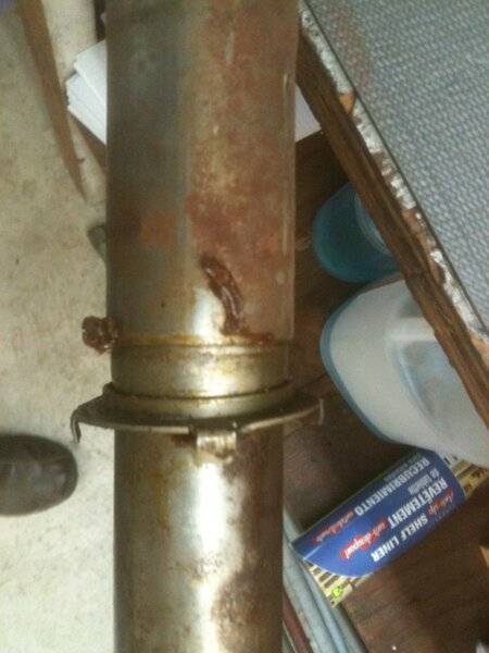

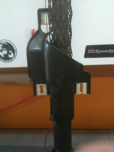

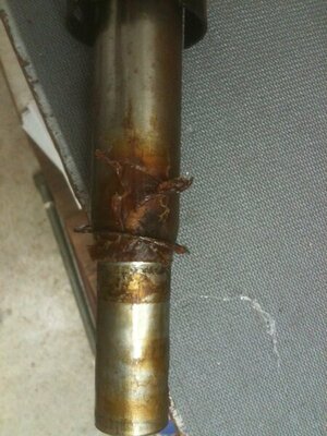

And for what its worth. ALL 1968-69 columns Ive worked on NONE have the inner tube mentioned

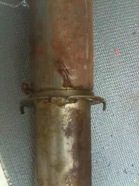

'69 B-body 4-speed floor shift ... with inner tube !!!
IMG_0824 (2016_11_22 02_37_15 UTC).JPG IMG_0828 (2016_11_22 02_37_15 UTC).JPG IMG_0829 (2016_11_22 02_37_15 UTC).JPG IMG_0830 (2016_11_22 02_37_15 UTC).JPG IMG_0831 (2016_11_22 02_37_15 UTC).JPG
