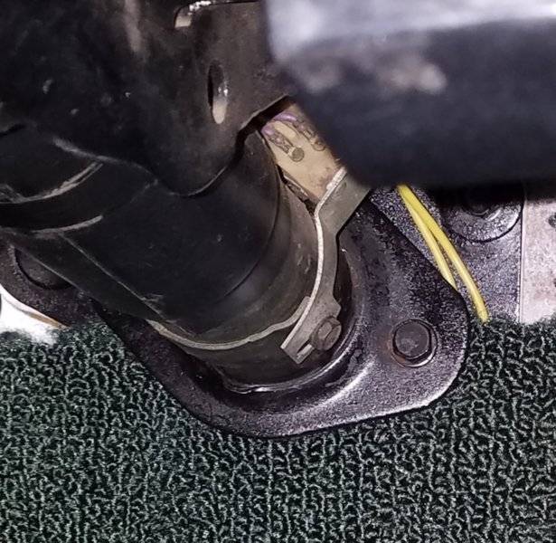

Can someone post a pic of how the column goes through firewall. Does the steering column support mount under or over the carpet? Thanks in advance
Here's mine- 1968. The big 4-bolt plate is under the carpet. I trim just a tad off the top edge of the carpet to fit under the column...that way I can get the carpet up as high as it will go and have the heel pad in the proper location.
