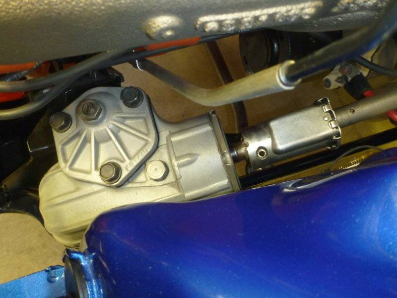

so, dadsbee, put the punch there on top? or it needs to be punched from the bottom?
Pin will go out in either direction. Make sure your punch is the correct size and not too small (jamming inside) or too big interfering with the coupling.

the pic is dadsbee's, mine is nowhere near that clean

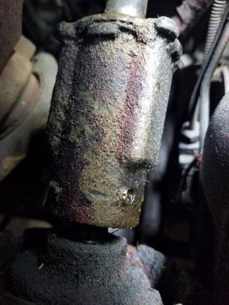

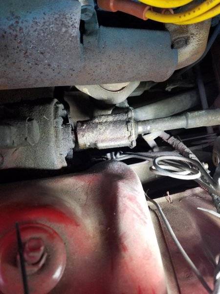

I put a punch through the spot on the coupler. I did't have anything in it. I haven't tried to pull the column yet, that's tomorrow's mission. Is the pin hollow? Or could I just not have a pin

As shown in my picture and described... it is a split pin. I can see the pin sticking out of your coupler. Why I said don't use a punch too big.. or too small. You need the correct size to be just smaller than the OD of the pin.
used a 5/16. I got the pin out, now the punch is stuck. I can rotate it but can't pull it out. I'm going to come up from the bottom with a small punch and knock it out
