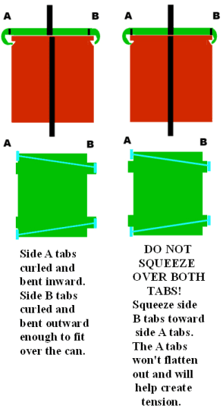

I've never had a problem getting the cover to snap on & stay on... I don't try to bend the tabs with the cover held tight to the coupler body... Instead I pull the retainer away from the coupler, bend all eight tabs so they hook slightly into the body & then snap the cover onto the coupler body... Usually I have to use a small screwdriver to pry a few of the tabs over the coupler body... Try it, you might like it...

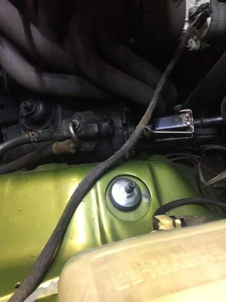

How I do it if it makes sense to ya'. Tedious and even more difficult with less space, but I've had decent results with this learning from multiple failures on my old 77 Ramcharger steering.

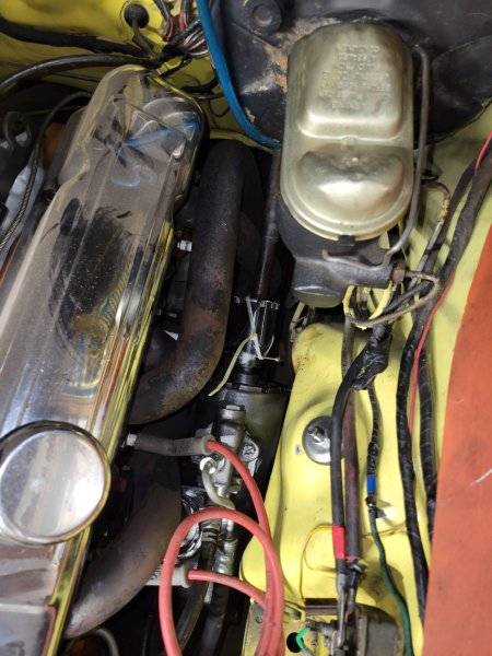

For what its worth...after packing the joint with good grease I pre bent the tabs then used 2 zips tie crisscrossed to pull it into place then cut the zip ties off. Its not going anywhere in my life.
