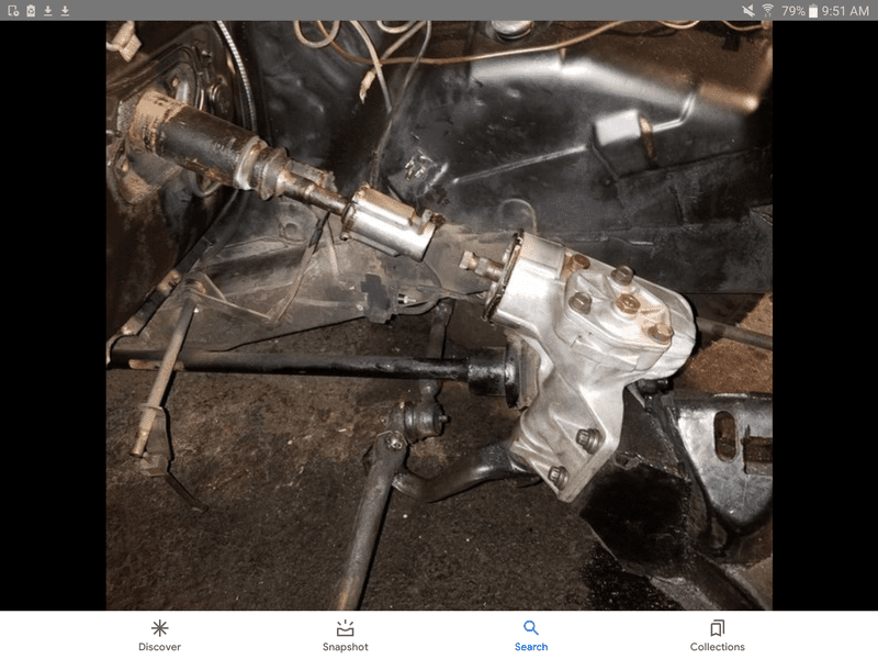

Power column and manual box would look like this. The adaptor I mentioned would go in between.
Power column and manual box would look like this. The adaptor I mentioned would go in between.View attachment 1267658

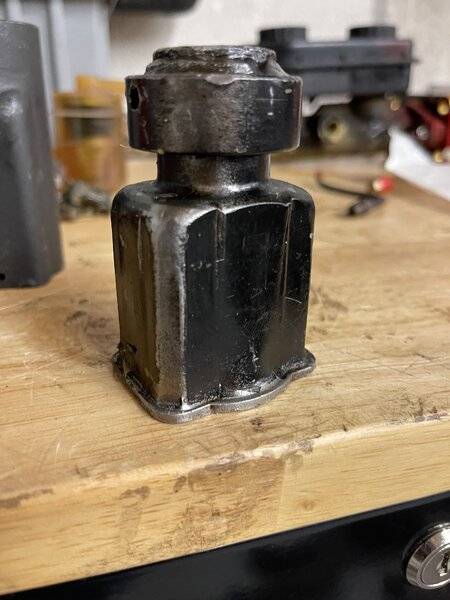

Thanks for the picture, it helps. Here is a picture of what I have.. its different but I suspect it is a correct item because I have zero gap between the coupler and the box. I should be able to rebuild this one and get it installed. On the steering shaft, do I need to press that cross pin out?
