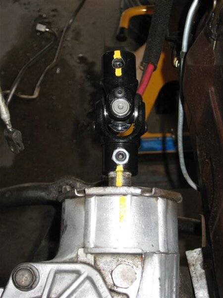

I used one made by Flaming River many years ago to correct a problem I couldn't figure out at the time. Mine used a roll pin to secure but the one you posted says weld on. Either way you have to cut the steering shaft. It worked fine, but I wouldn't do it again. My problem turned out to be the drivers side frame rail was crushed in 1/4" and caused the steering box to be angled wrong.
I have the pin one on my car because I put a new PS box on my Bee. The Bee had manual steering.

I used one on my old cuda. I drilled it and used a factory style roll pin, and I never had an issue. The factory shear pins in the column had slipped anyway, so the column could move
a bit.

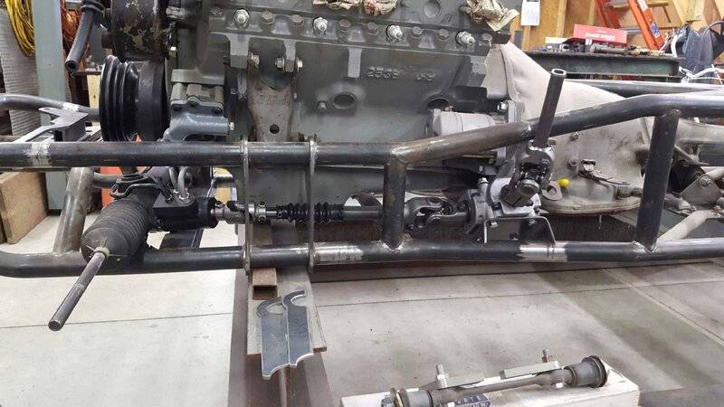

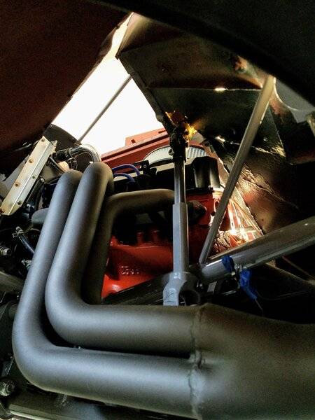

The steering system on the build I'm
working on has no rubber/fiber coupler, but
instead, makes a 90 deg turn thru a mitre
box. Usually with a solid coupler, on long
highway trips, steering wheel vibrations
can actually make your hands numb, or a
"fall asleep" feeling as there's no 'give' to
the system, and the steering picks up
all road vibrations.
Note the miter box and steering coupler
in the pics. This build will not be driven on
long hauls where the sleepy hands affect
occurs. The rubber/fiber couplers reduce
the frequency of road feel.
