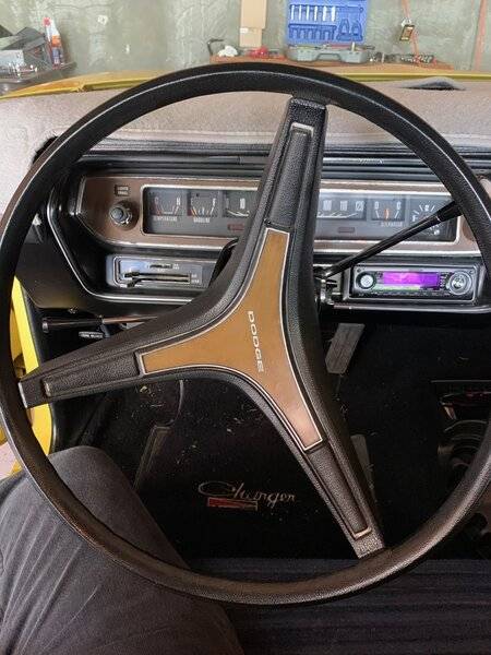

OK, so I got the alignment done after the front end rebuild. Alignment is "perfect". I'm very happy. But the alignment guy and I talked about why the steering wheel is 45 degrees off. I did remove the steering wheel once to replace the turn signal switch and thought I replaced it the same. That was before the rebuild when the alignment was wayyyy off though. I just wonder...
What do I do? does the steering wheel go on it's splines more than one position?
thanks in advance.

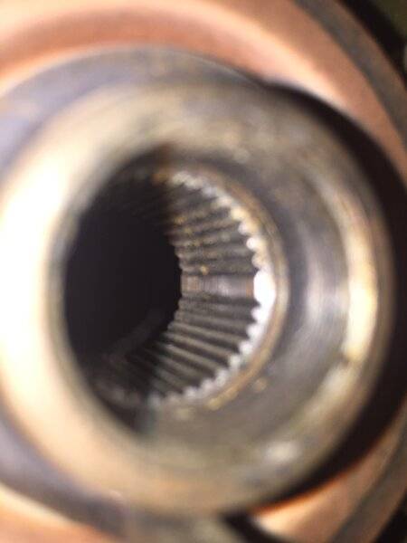

If a factory stock wheel, it will install in one position. See the doublewide spline on the wheel from my 1972 Charger.
Yes, I recognize that. I did have my steering wheel off once to replace the turn signal switch. I know it went back on the same way. Curiously, the steering wheel was just a little crooked before the rebuild. Major reason for full rebuild is that all bushings were shot and I had the terrible tire wear.
