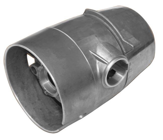

Not easy to see but this is the collar with the lettering
Repro pieces for the floor shifter conversion... unlocking collar included

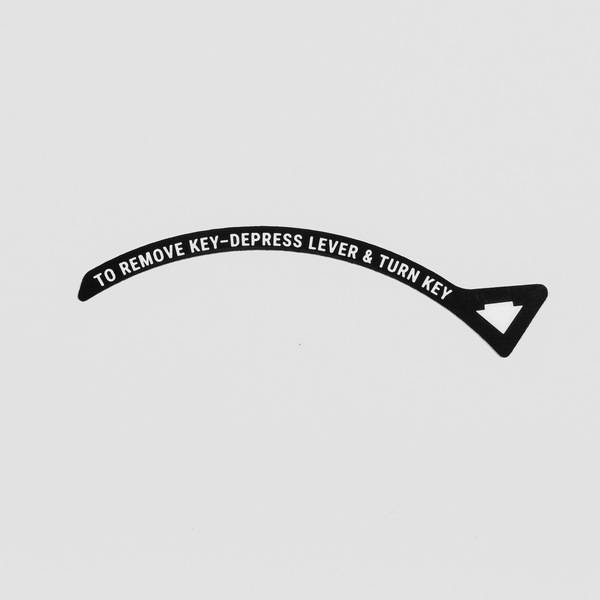

And repro decal ( to be attached to the original aluminium sheet insert in to the collar provision indent for that )
Nacho do you have a source for that decal? I'd sure like to have one!!!
