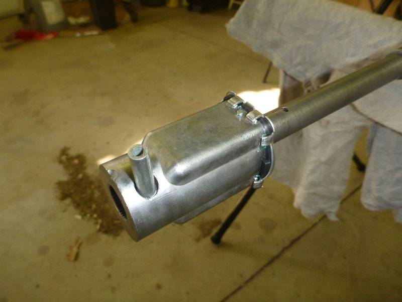

It has been a while since I installed the Borgie in my car but I seem to recall that the Borgie spline and coupler are not keyed. You need to center up the steering sector then make sure the steering wheel is centered when you slide the two together. Mine is about 6 years old. I know they made some changes to the sector since I bought mine. They could have keyed the splines since then.
Notch indicates "key" on OE coupler.. it is up to match key on box spline. Small hole on steering shaft up as you assemble. I have no idea if the Borg box is keyed, but I'd certainly think it is and you could use an OE coupler to install. Seeing the OP is also exactly 180* out I doubt he fluked out on spline line up if not keyed.
The bergman coupler is not keyed, it just goes on, Thanks to you guys now I know I put the coupler on 180 degrees out.
