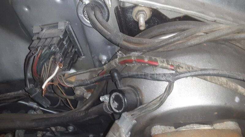

The wiring at the bulkhead is kind of hinky. There's a jump wire going from a brown wire that isn't connected to the box to a sprig of a wire shoved in next to a purple wire at the box. I took off the jump wire and I got nothing. No crank, lights, anything so I put it back.

Yikes, I would first repair that wiring concern correctly. Starting issue related or not.
I will. I'd like to get it started first. It ran for years like this and years before I got it.

Just spitballing and I think it is more likely an electrical issue at the bulkhead or ignition switch.

is ground wire attached from engine to firewall on pass side?
I had an issue with my 73 where it intermittently died. Turned out to be the tack wire occasionally grounding to the firewall where it passed through the hole in the firewall.
I suggest you remove anything electrical that is not needed for the ignition, and also check your grounds and be SURE they are clean and well connected.
