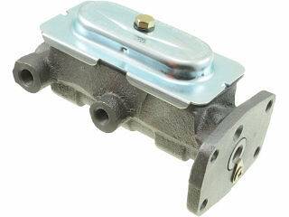

it has a master cylinder like the following....i guess this means its been changed?

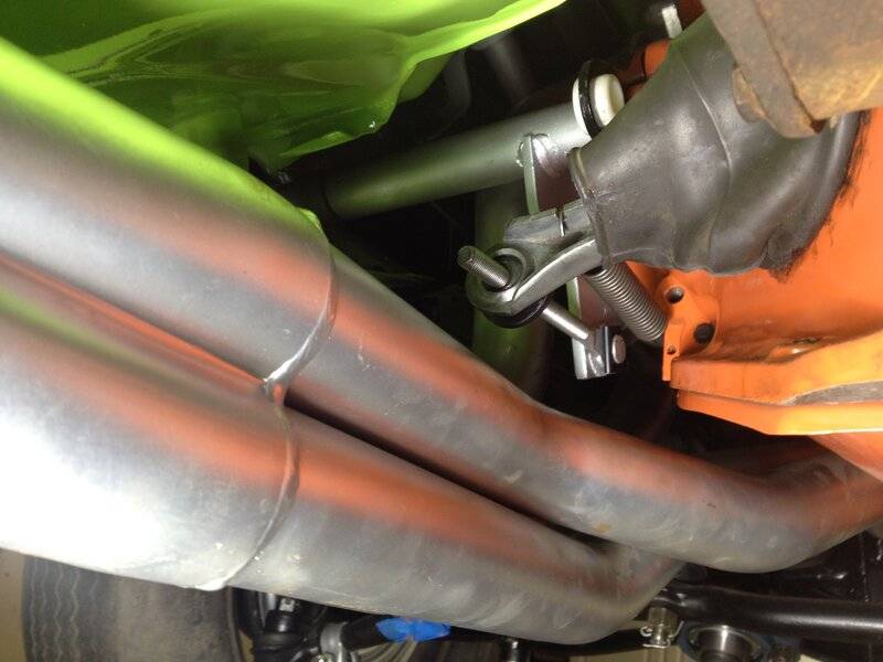

Here is my unrestored Z Bar. Basically a bar with two metal tabs welded on it:

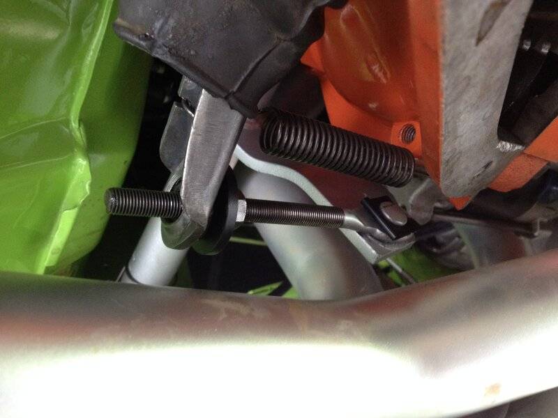

Here is my restored Z bar (silver) connecting to the clutch fork:
The bottom of the Z bar pushes the clutch fork via the threaded rod that connects from the Z bar to the fork (poking out from the rubber boot). There is a nut on this metal rod that adjusts the clutch, although it seems doubtful that it suddenly got changed during shipping. There should be a couple or millimeters of play in this before the fork contacts the throwout bearing, and should should be able to feel the clutch fork wiggle a little bit. If it moves a lot, there is a problem.
or is that for the brakes?
Haha, I'm probably making a fool of myself!!!...
No, you are learning and asking questions - that is great!
What you have pictured is the master cylinder which is for brakes. It has nothing to do with getting the car in gear. If you have problems stopping, then that is another story!

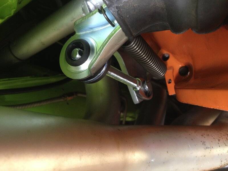

Here is another view of the bottom of the Z bar connection to the transmission.
And another (note here the clip that attaches the rod to the Z bar is not on and it is not adjusted fully):
