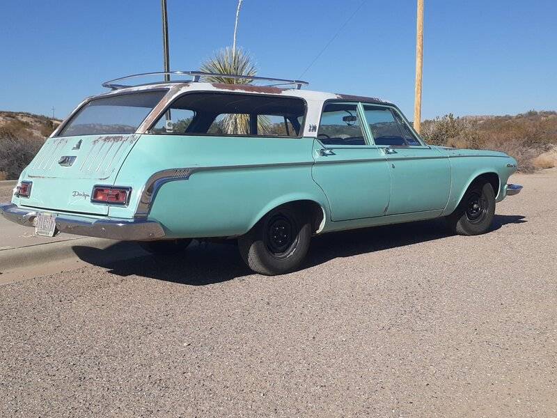

Gonna get a set of dual exhaust installed next week on my '63 330 wagon with a 318 poly and stock manifolds. Planning on 2" exhaust pipes, glasspacks, and 1 3/4" or 1 7/8" tail pipes exiting behind the rear wheels.
Should I have them put in an "H" pipe? Also what length glasspacks would you recommend? I want and old school sound, not a "muscle car" growl.
