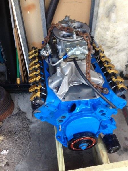

My neighbor just had a 400 stroker built. I don't know all the specs but it dyno'ed at peak HP 723 hp 678 torque. I think he said it was running chevy 454 rods.. I have the dyno sheet here with me. I guess its legit. This is the same guy who grenaded the last engine he had built. forgot to add that it has a displacement of 425 cubes.. The thing is sitting in my garage now waiting to be put back in his 69 barracuda. Yep thats ford blue. It matches his tube chassis.

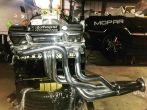

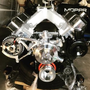

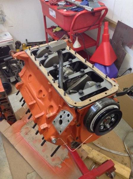

Mines a 12:1 victor head around 700-750 range. Girdle, eagle crank and rods, mahle pistons, girdle. I’d say go for it, should be fine if it’s assemble correctly! Hope to see you guys out at 41 next year!
FCD66640-0F95-4CE4-BCEC-AD511ECC7B28.jpeg 2DC38AE1-9B16-4946-9C08-E37A493BC394.jpeg

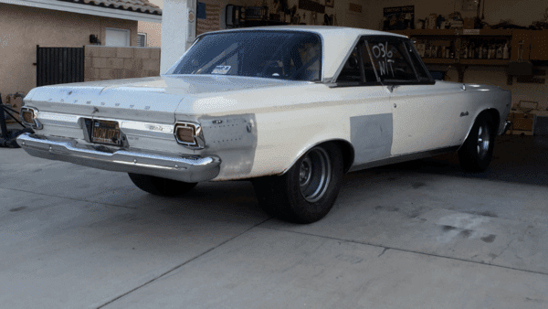

I'm running a stock Bottom End, F'N CAST CRANK !!!! LY RODS, KEITH BLACK HYPEREUTECTIC PISTONS,
TRANSBRAKE!!!!!, LEAVING @ 3000RPM SHIFTING @5000RPM 10.36ET @129MPH PUSHING A ALL STEEL 65 PLYMOUTH WEIGH'S 3530LBS 700HP ALL DAY LONG, 3 YEARS NOW????? FORGOT TO ADD 250 SHOT
OF NITROUS,

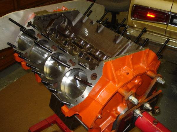

My 500"/440 using 440 Source crank and rods, Ross pistons and a Pro-Gram 4-bolt main conversion has progressively gone 750, 850 & 928 horsepower.
