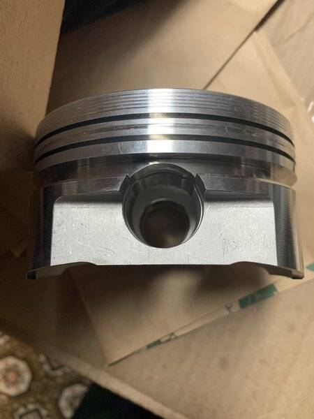

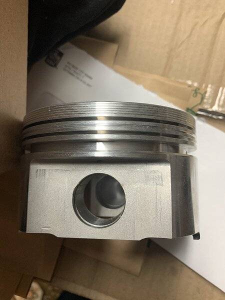

I have have never seen a 4.5" stroke RB block in the wild. What rod were you considering?
Im using 7.1 BBC rods in my 4 3/8 combo too. The whole build is built around using pistons I got dirt cheap. Yeah, really stupid, I know!
Damn. Those pistons must be like pancakes. (Assuming you not above the hole?) I run 6.7 rod with RB 3.75 crank in my 451 to very near 0 deck. (Block was not decked. So I'm sure there is some discretion and variation.) I know it's a B short deck. But the Ross pistons are definitely lower profile. With 4.5 on a 7.1 rod? Doesn't leave alot of profile room? Would love to see a pic of piston/rod combo?
I think Kim's setup is for a rb block. Mine definitely is. Dished piston, and the pin isnt even in the oil ring .
They’re typically 1.32 to 1.35 CH. plenty to not have the rings in the pin bore. Some of the SBC and BBC stroker stuff is 1.10 CH.

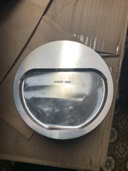

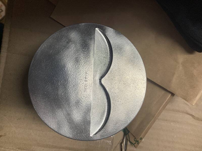

Mine are for a RB block. The oil ring is in the pin. Which in reality is a non issue. The first and 4th pics are the 543 piston. The 2 and 3 pics are a 505 piston. The 543 uses a 7.1 rod with the 4.5 crank. The 505 uses a 6.8 rod and 4.25 crank. Kim
E0662F0C-CD2B-4044-9B1A-A0584A5E7537.jpeg 4B56742F-D671-4372-9CA1-51EBE0E357A4.jpeg 955F8A49-F75E-4687-8C83-21E86F533D6B.jpeg A252E6A8-0B71-4B5B-BD76-36A848942485.jpeg
My oil ring is below the pin. 4.50" stroke, 7.10" rod. Previously it ran BME aluminum 7.15" rod. The pin was below the oil ring as well.
Doug
Doug
Good application for pin buttons. I’m definitely gonna be using pin buttons in my next one.
So I would imagine pin buttons will throw the balance out. I think I have heard of them but I forgot about them. Where would I find them? Thanks. Kim
