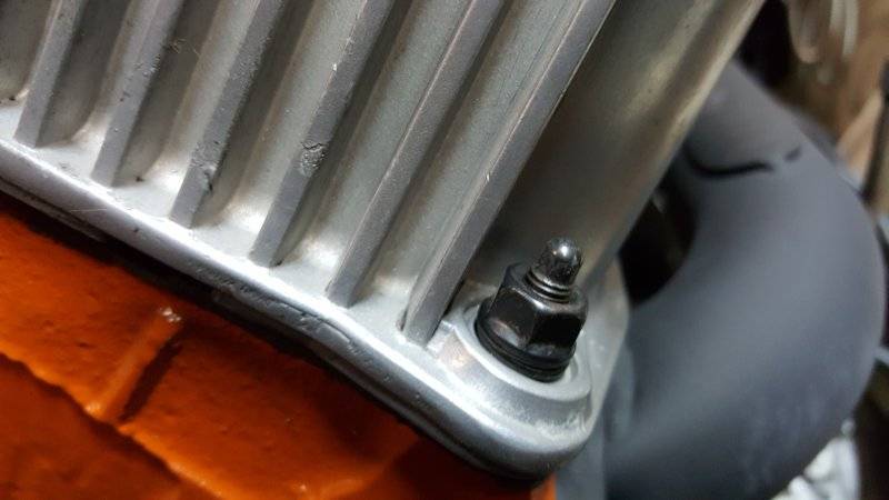

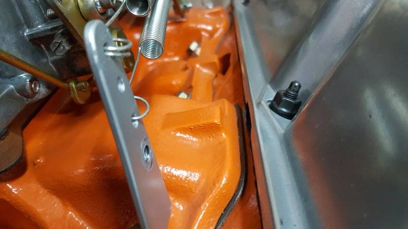

There appears to be around a half inch of thread in the head. I used 1" long 1/4-20 with a six bolt cover and cork gasket, standard thickness washers. On my four bolt covers I used 1 1/4" because of 1/4" home made load spreaders. 1 1/4 will work in most applications, just might have a little excess thread showing.
It's worth the money for a quality product. I used ARP with my cast valve covers. I like the tip on the end for ease of starting the nut.
I've always been curious as why the holes in the head are drilled at a slight angle. Maybe for ease of installing the cover? I know with the bottom row, you have to start the nuts by hand until they are low enough to get a thinwall socket on them. You don't notice this as much useing bolts.

I'm using the 452s in my pics. The angle is pretty steep on the studs. More than I remembered them being. Takes a little effort to get those cast covers off and back on. (Rubber Mallet)

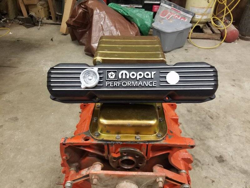

I tried for too long and could not get them too work. Finally gave up. I had a hell of a time just using bolts. Sure hope I don't
need to pull valve covers.
Probably will because I want to put a better rocker assy in eventually.
I suspect that these cast MP covers may also be to blame

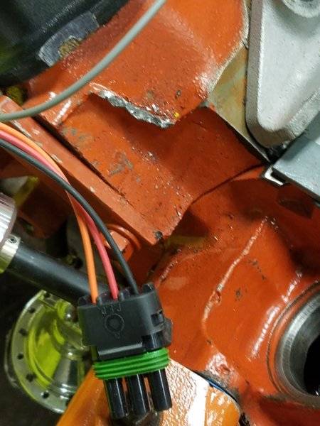

I also had to do a little machining with a ball peen hammer on the right head to get the R2R dist to work.
I bought the plain unpolished summit cast valve covers and test fit them on both victors and 906s, because of the bolt angle, (and because they're chinese). The center lower row of holes had to be moved almost an eighth inch to work with either head, bolts or studs. The gasket surface was good (after I sanded it on a granite surface plate) , but I fear sealing up the breathers might prove to be an ongoing problem.
