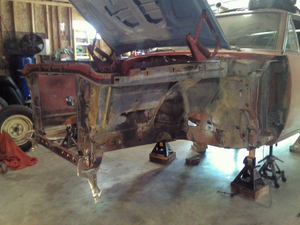

Looking for ideas on how where to store fender n doors etc while doing work... THANX !

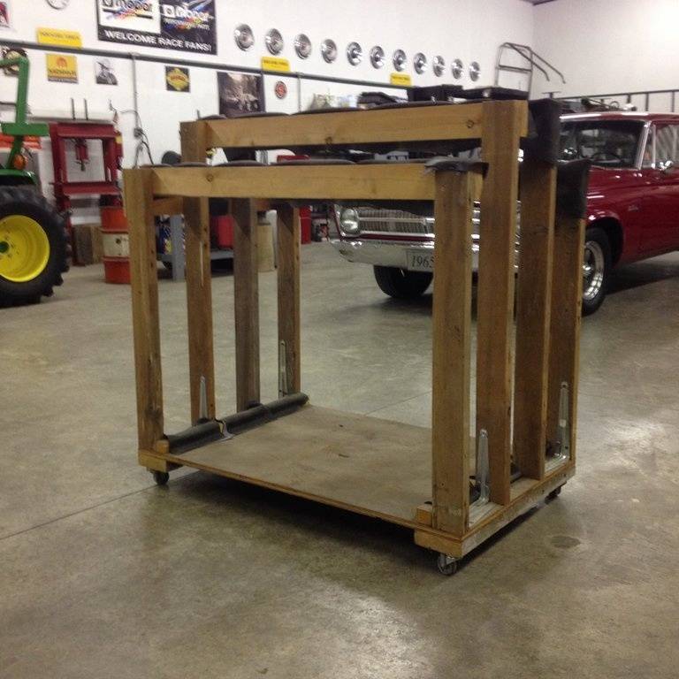

I slapped together a wooden rack about the size of a pallet, a piece of plywood, some 2x4s, casters and rubber padding. The hood stands up in the center, the doors go on each side of the hood, and the fenders hang on the outside. It worked really well and you can move it around. I could post a picture if that would help. Just scrap lumber, might have paid $15-$20 for the casters.

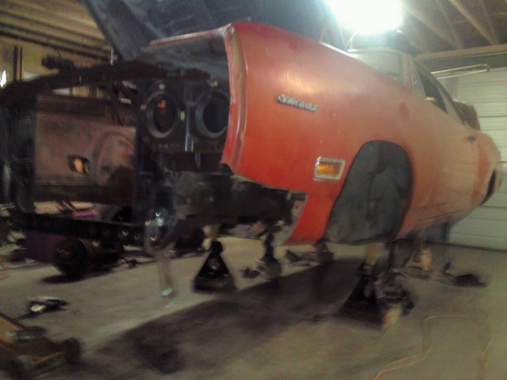

My flat hood is up .....
If you would PLEASE n THANK-YOU !!!

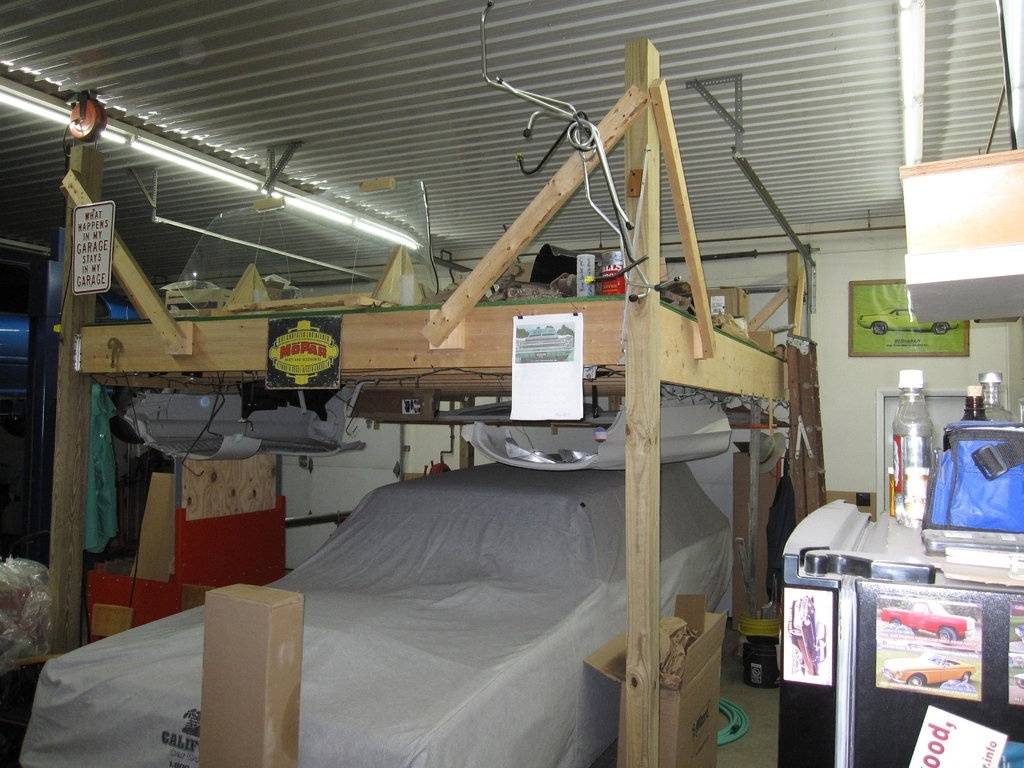

I built a screwed together mezzanine for storage. I hope to sell it when the car is done.

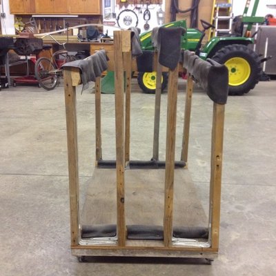

Measures 48"x30". 42" tall. Nothing fancy but worked well for me. You might have to adjust the dimensions to your application. '65 hood, doors, and fenders is what I used it for.
