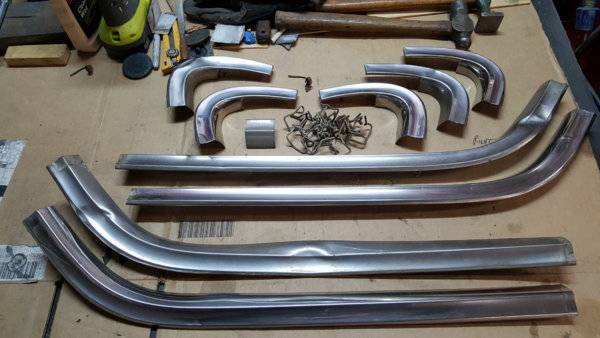

I had these to straighten out.
https://www.forbbodiesonly.com/mopa...p-new-residence.114133/page-21#post-910817315
I've done a fair amount of SS and aluminum trim and a kinked piece of stainless might be where I draw the line and tell the guy to be looking for another piece as this one may well not survive. I hammered and tapped some pretty big dents and creases out of aluminum but it generally is thicker and gives you more to file and sand with. By the time you get the kink hammered and tapped out of SS and file it flat, it might be too tissue thin to stand up to buffing.

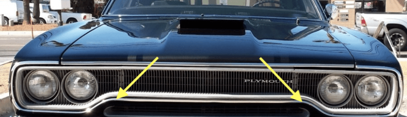

I'm assuming this is the trim your working on?

I've done stuff like that and, no offense, those pieces are easy compared to this piece I'm currently working on. I think part of the problem is that this has a lot of tight corners/edges. Those pieces you have look fairly open in the back, fairly easy to get to. This piece has a low spot right on the character line and some how the side that has the screw holes is stretched.
Sometimes if it is stretched you will have to cut it, remove some material and tig weld it. Tig weld only with trim as any other method causes issues with chrome plating if you need that. As far as the character line about all you can do is thin out a piece of flat steel that will fit in that area to almost a v, polish it, and work slow.
I did think about that and if it were my piece, I'd probably do it. I've taken almost all of the low area out of the character line, I just have a thing for getting it perfect even though this is a twisted POC. I've got an idea I haven't tried yet, I'll let you know if it works.

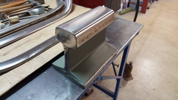

Just wondering where you acquired a piece of rail track? How much does that weigh?
I believe I found it at a garage/yard sale years ago. Been hanging onto it for a long time and finally put it to use doing my stainless. It weighs enough that it doesn't move around much. When I used the side of it I just clamped it to the bench.
