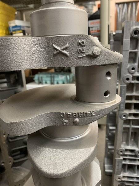

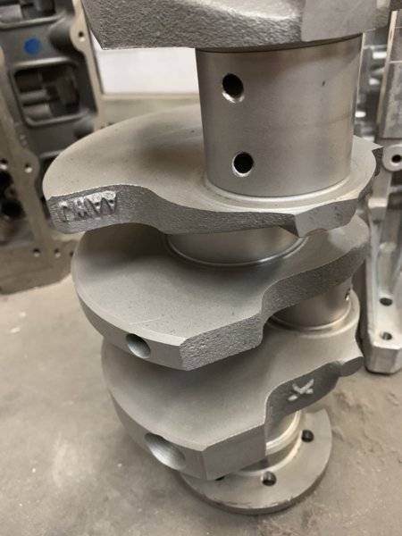

How do i identify that the crank is original? Think i saw a pic that there is "360" casted in or stamped in, but i cant find it any more.

Aftermarket cranks look nothing like OEM cranks. There are no casting numbers, and the craftmanship is different. Just google Scat or Eagle and look at their cranks for an example. Here are two pics of an original crank for reference. You can also google the casting number you find to ID it.
