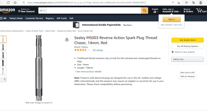

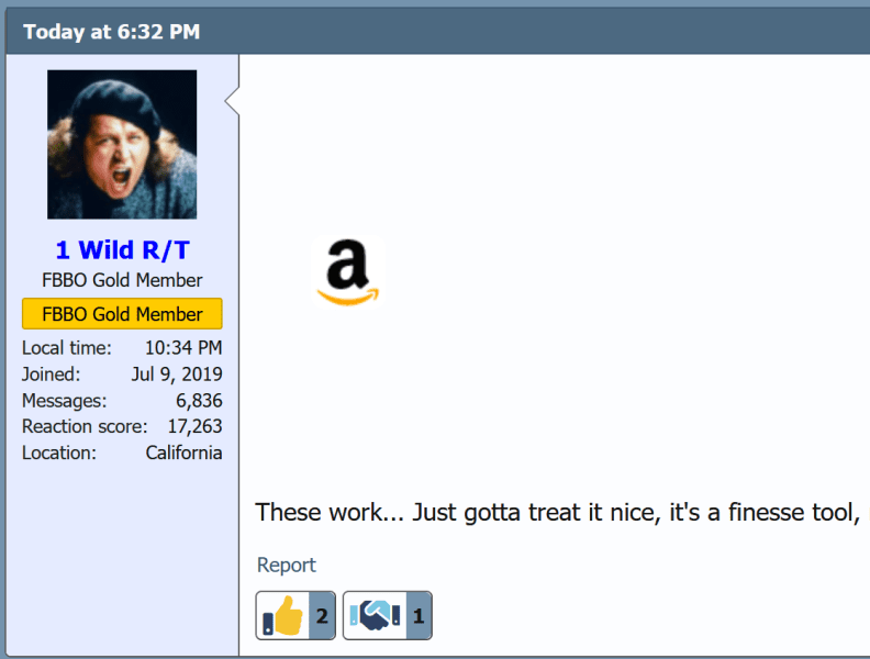

Amazon product ASIN B0086306NO

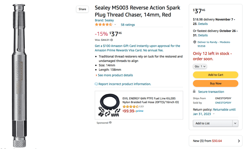

These work... Just gotta treat it nice, it's a finesse tool, not a Bubba grade tool... But if your careful it works pretty well..
I was thinking I may need something "like that" and that tool is exactly "the thing".

I've had one of the Lisle chasers for 30+ years, they do work well... But you need to catch the original thread, if you start threading into the damaged thread it will follow that & after that you'll be drilling & helicoiling the hole... The one I linked above grabs the threads deep in the hole & you chase the thread on the way out of the hole... So it automatically picks up the un-damaged thread..

Unfortunately, I got no link out of your post, just an amazon symbol. :(
Strange it works for me & apparently others but not for a few... Heres a screen shot, enough info to search if your so inclined..
