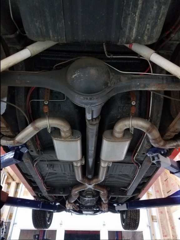

3" TTI to the bumper, x-pipe, mufflers in front of axle, springs moved in. Snug but works. Use mufflers with offset inlet/outlet.
See you got your lift in!!! Best tool in any shop! Is it the pic or did you change to flat oval after your mufflers???
Kinda, I put the pipe in the press with some softwood on both sides and made it oval to get under the springs.
Thanks, can't believe I resisted putting one in now. The downside is now I see how dirty it is and want to touch up the bottom haha. I do Love it.
