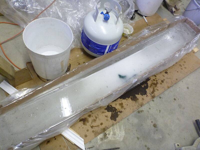

Today I stripped the tail panel and poured the left over 1 gallon in and then mixed up 3 more gallons with 10 teaspoons of lye in each in the trough.

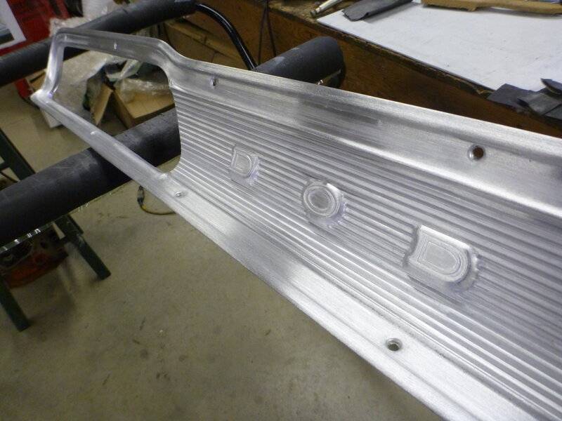

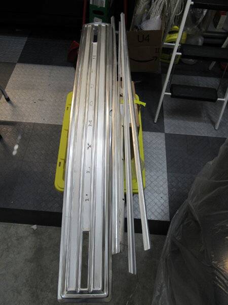

This was probably just a little on the weak side as it turned out but after an hour and ten minutes the panel was mostly stripped. The surface was still pretty slick and shiny in areas after cleaning off the black scum and there may have been a very thin coat of anodizing left. But a couple swipes of 600 grit sandpaper and it was obviously into aluminum. I think there is a very, very thin layer of soft anodizing left but the metal is still real smooth and it's so thin it will immediately sand off. I can probably start with 600 except where there may be some scratches or dings to fix. Sanding the aluminum is necessary to get rid of most of the pits, scratches, hide ding and dent repairs. In the past I've usually sanded down to 2500 and then use a 3000 3M Trizact pad on it. By that time it can usually just be hit with Mothers Aluminum Polish or run it over my buffer wheel on my bench grinder with a white aluminum compound and soft flannel buffer wheel. But how smooth the lye left the surface is the big plus to this method, as is the low cost and more uniform removal action.
In hindsight I probably should have used a little stronger mix than the 10 teaspoons/gallon. the 16 teaspoons seemed a little hot so maybe a happy medium is around 12/13 teaspoons/gallon. It may depend on the air temperature and it in a confined container like PVC pipe or an open container like my trough. You kind of need to monitor the part as you go to see how it's coming. I wiped the smudging off and hit a small area with a piece of 600 sandpaper and if it sanded easy and appeared to get down to fresh aluminum immediately I figured it was done.

Is that with lye Dadsbee? Your panel looks pretty much like what my trim came out like from the PVC pipe with a little stronger concentration. My panel came out a little less stripped but I think it will sand out fine. If not, back in the through for a few minutes. I also have a few remains of the original black letter paint in the recesses that escaped both my lacquer thinner and the stripper. Tough stuff.
