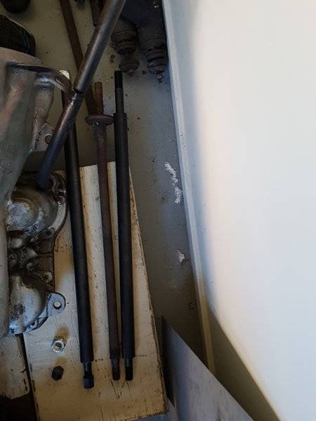

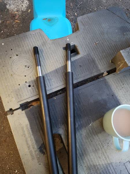

I had the same problem. From memory I was going to cut down the bushes - I think it's a common issue and there were measurements and drawings from the A bodies forum I think. In the end I was able to leave them alone, as my new mancini racing strut rods were too long themselves and I had to have them turned down. I had a bit more taken off the shoulder to accommodate the thicker bush. View attachment 656194 It all works well.View attachment 656184
I cut my Mancini rods down in a lathe also.
You guys are getting me nervous about the solid Mancini rods I just ordered for my Bee. Their description states that they are the exact same length as stock. Not so?
I understand a few people have had issues with them. I contacted Mancini and was told they were fine, they sold lots of them and everyone was happy. This was a load of b.s. as they were clearly longer (see pic). Luckily a local guy turned them down for about $20 a side. Other than the length they are good - very solid.
