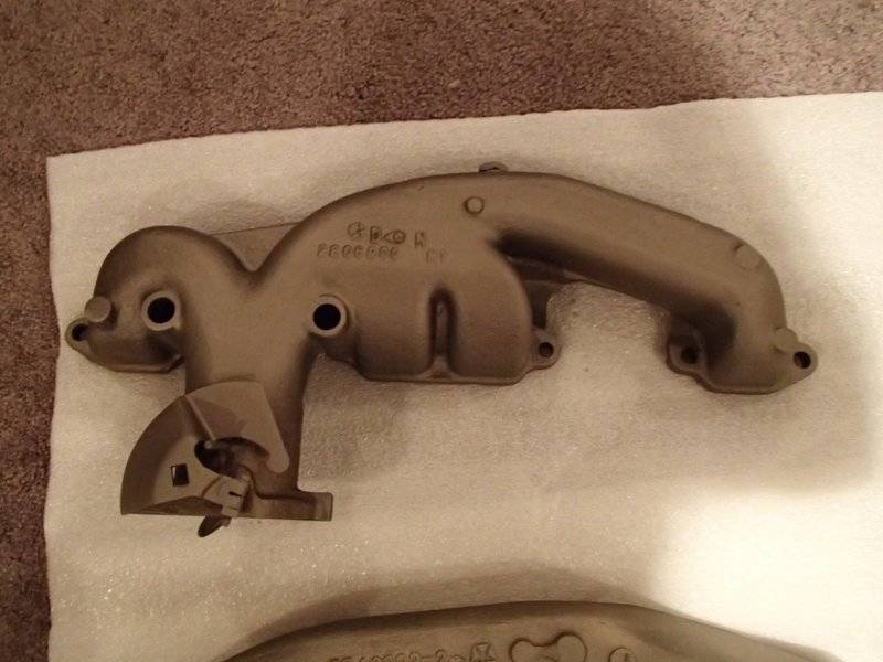

The position of the riser on the outside, it should move, if not, it's stuck, and probably stuck partially closed

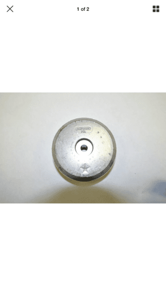

Depends what style you have, I have this style, and on one car it's almost in this position (stuck a little closed) my other car, the riser easily moves by hand
