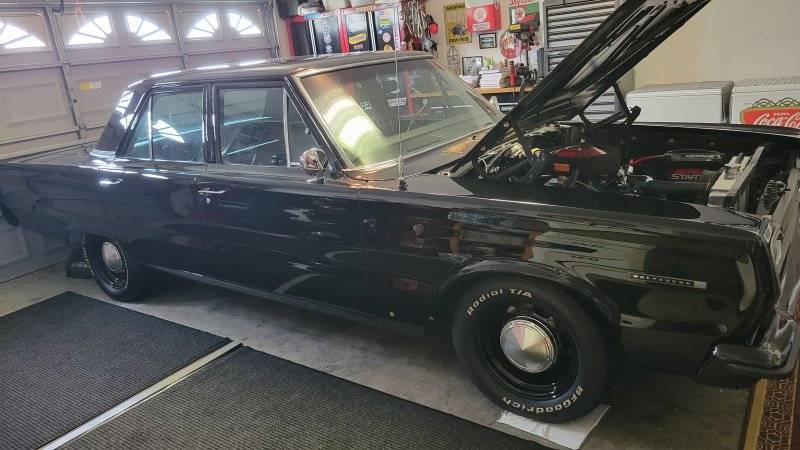

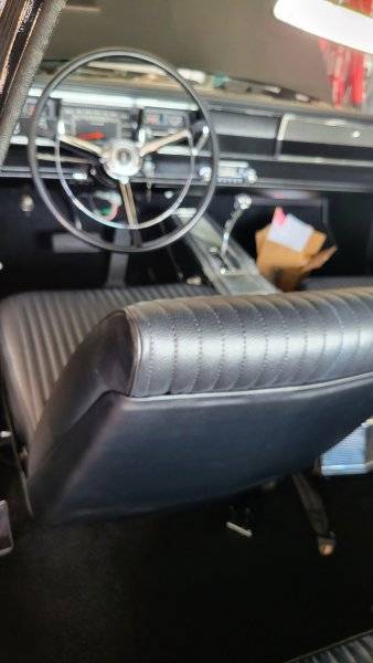

I know this isn't unusual. I took a part a four door '67 plymouth belvedere 4 door. On the floor pan the provision for the console shifter was stamped into the floor pan with the three dimples on the perimeter were there also, the left rear floor pan also had the provision for a dual exhaust rear hanger. Yes the car went back together
