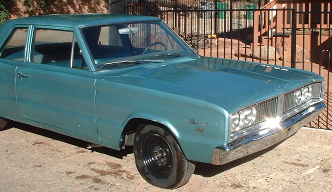

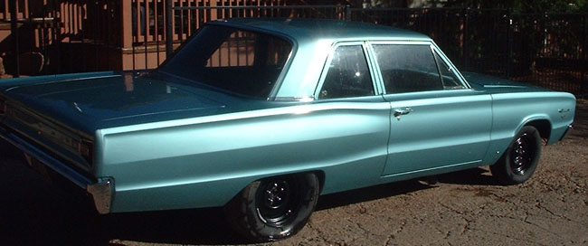

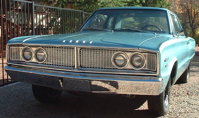

On my 66, I opened up the rear frame rails and stuck the 2x2 into them. I thought about welding them to the bottom of the rails but I didn't want them any lower than I had to. Year back, I had a 68 Road Runner that was done with the 2x2 and it was welded to the bottom of the frame and I didn't care for that very much....

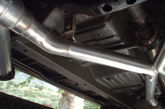

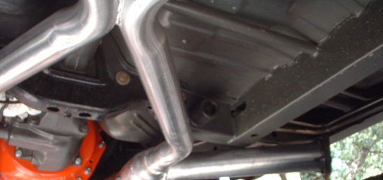

WHOOPS!! Sorry, I didn't look at the pictures before loading them.

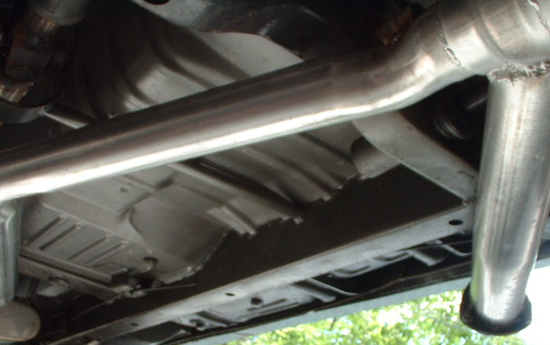

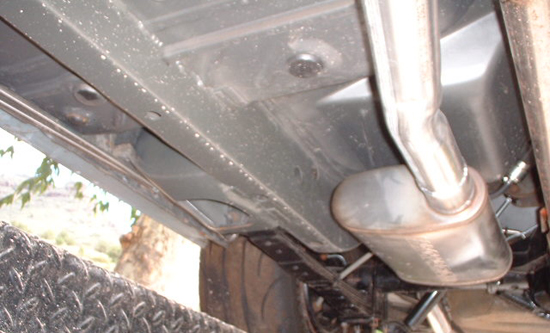

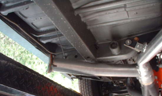

Here are some of the underside ones.
