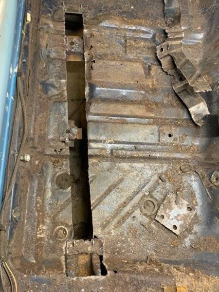

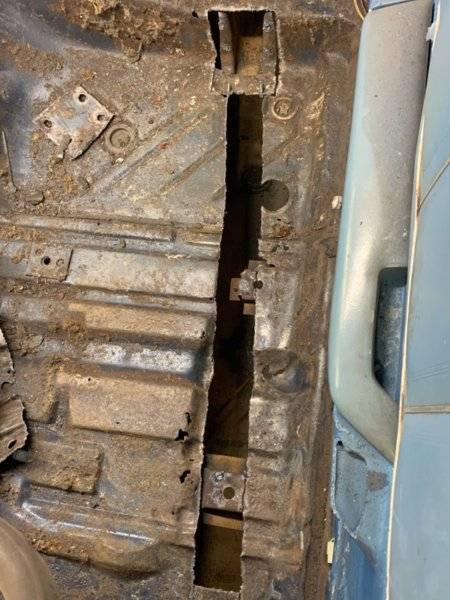

has anyone made their own sub frame connectors for a magnum? i'm looking for some pics of how you did them. we have the car on a rotisserie and have been cleaning all the factory underbody coating off so figure if i'm gonna build them now would be the time to do it. i've been looking at it all day and am thinking to go from the main cross member and leave the floating torsion mount alone. i don't want to have them thru the rear floor or hanging below the rockers. so far i'm just not picturing a good way to build them so looking for some ideas.

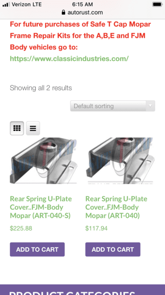

https://www.autorust.com/product-category/mopar/mopar-fjm-body/

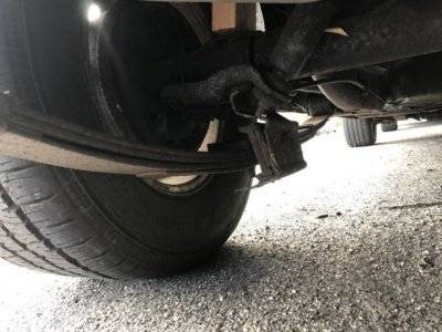

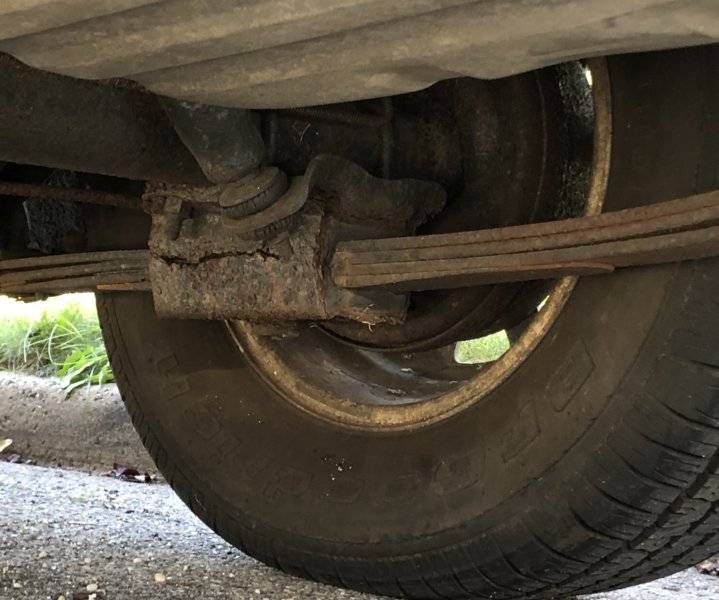

My Passenger side U Plate, rusted ready to crack. I’m gonna do an ISO delete and run B Body Shock Plates.

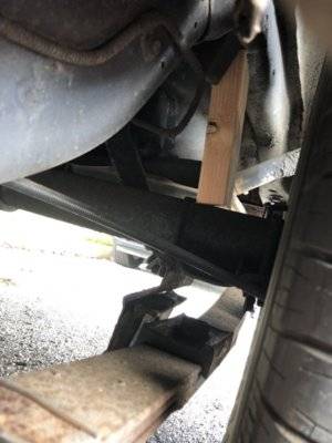

My DS let go close to home and at 30 MPH..... The rear axle goes up into the wheel well and the spring drops to the ground scraping the pavement......
A quick temporary fix is to jack the car up and insert an 8” Long 2X4 between the axle and frame.....

I’d suggest anyone having the ISO plates to inspect them. It’s an easy upgrade to do an ISO delete and swap to standard 8.75 shock plates.

ok a couple more questions are the mounts even needed fir the torsion cross member or could i just weld it solid and tie it into the connectors when i build them? and how are you guys reinforcing the rear shackle mounts? his don't look bad now but i've had the leafs come thru the trunk on a cordoba and a magnum in the past so figure now is the time to it since it's already on it's side and i will have alot of the trunk pan out thanks to michigan rust.
Not only is that ISO contraption trashed, so are your springs.
New springs and as you mention ISO delete with 72 and prior shock plates and shocks to match.
You will have to weld in a washer into the axle spring mounts to positively centre the new spring centering pin. (but FF also makes a kit for this as well)

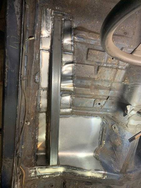

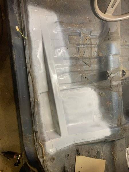

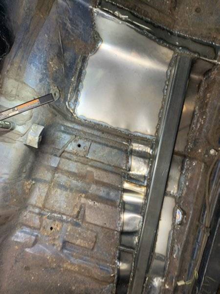

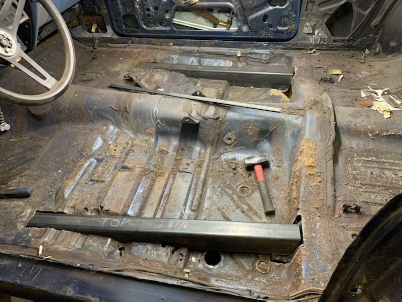

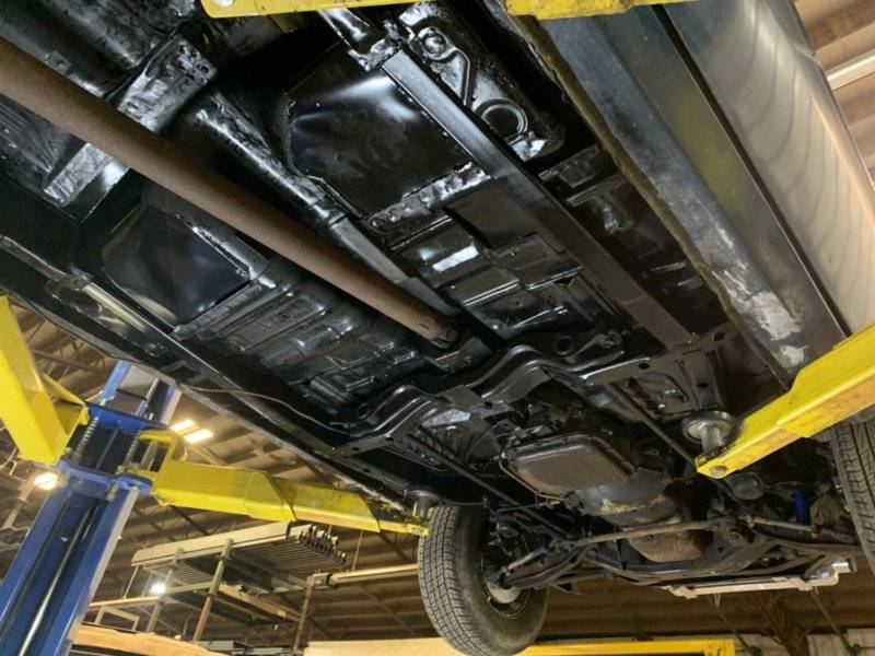

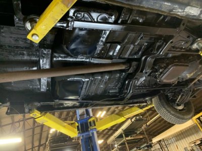

I know this is an older thread but here is what I have going on with my powertour car.
Sorry if the pics post out of order
