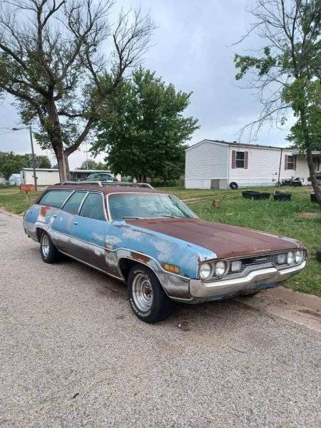

I have a 71 Satellite wagon and I'd like to find all the door seals for the ol' girl and I haven't found anything specific for it. I'm also looking at replacing the rear gate seals. Any input is appreciated!

Not sure where to look but I would start by getting the Mopar part numbers and look for possible OEM.
If it's just the door and gate weatherstrips, I'll try to un-lazy myself and look 'em up for ya later.
L/F door 3439737, L/RR door 3440045, R/F door 3439736, R/RR door 3440044...... Tailgate: L 3581169, R 3581168...... Tailgate glass: 3499770, 3499771, 3499768 These part numbers are from an old Mopar parts catalog, numbers subject to any superceded numbers.

Looks like most are available at about 150.00 each.
