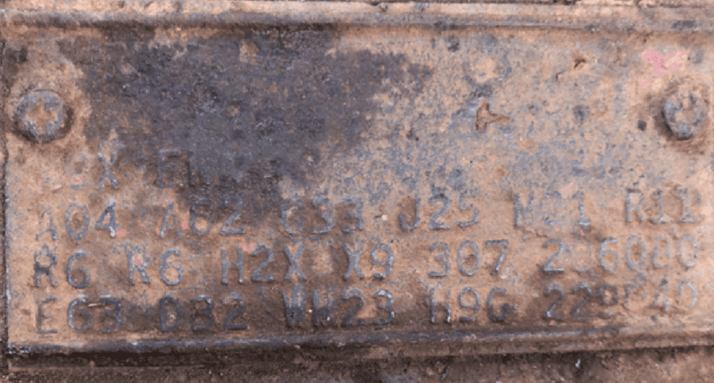

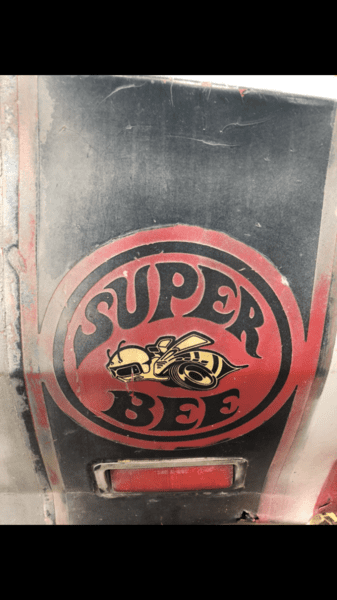

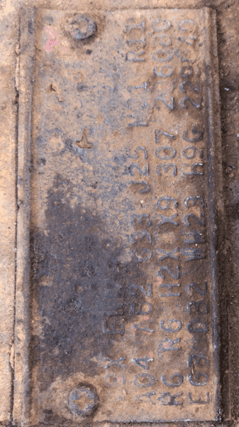

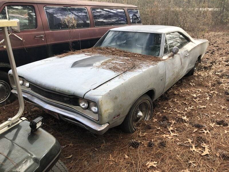

Can any of you guys tell me if the color on my car is red from the factory
Thanks, I wanted to be sure before I started disassembly. I new you guy would know. I haven’t got the tag codes down pat yet.
I’ve found original paint in some areas like under weather stripping and behind door panels.
Black stripe is correct... Pretty low option Super Bee...

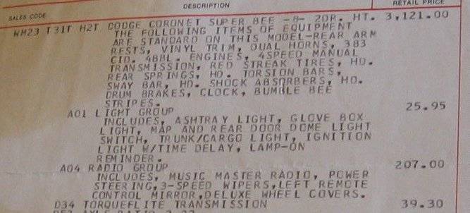

Yep no power brakes no A/C hell I don’t think it even has power steering. Red with black stripe and bulged hood that’s it. It’s still a Super Bee though.
Three things coded on your tag, the Radio R11, the three speed wipers J25 and the remote mirror G33 as well as power steering, which is not coded, were included in the A04 Radio group package.
A62 dash, M21 drip rail molding and V8* stripe were standard....

The code in the upper left should be for the stripe. I can see the V8X
From "MyMopar"
V8X: Tranverse Stripes, Black
From "MyMopar"
