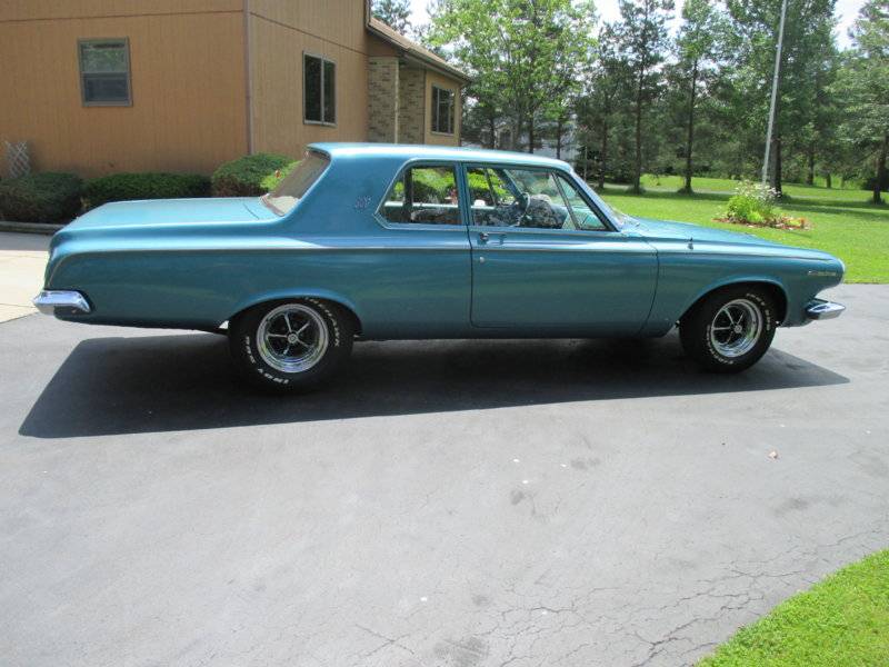

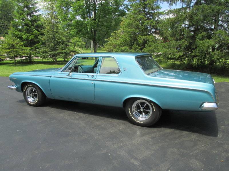

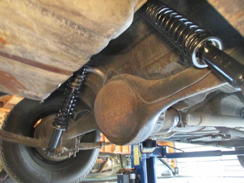

Here's a few pics of my '63 before I started the restoration. It had the original rear leafs that were showing there age. I added a set of booster shocks, the ones with the coil springs on them, and that raised it to the level as pictured. I was able to run 275/70x15 out back easily. The car was a /6, so NO real power concerns there, and the ride was very comfortable for everyday driving. Also, you can usually pick a set of these up for under a $100...
Here's a few pics of my '63 before I started the restoration. It had the original rear leafs that were showing there age. I added a set of booster shocks, the ones with the coil springs on them, and that raised it to the level as pictured. I was able to run 275/70x15 out back easily. The car was a /6, so NO real power concerns there, and the ride was very comfortable for everyday driving. Also, you can usually pick a set of these up for under a $100...View attachment 709124 View attachment 709125

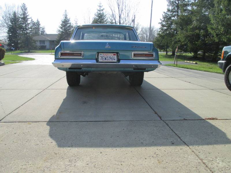

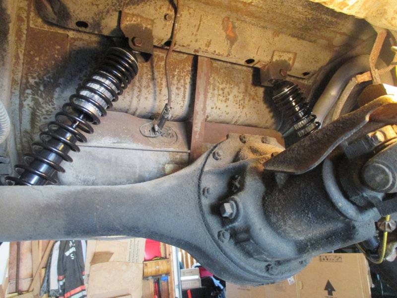

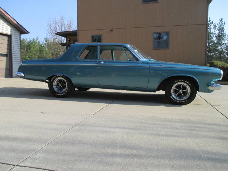

Sorry, I don't remember, but I probably just ordered them from Jegs or Summit. They are currently on my '65, for the same reason, with the sagging original rear
springs. I may get a chance later, to get out to my trailer and see if the shocks have any ID on them. Found these other pics:

That looks awesome! Exactly the look I prefer.

Careful though! That shock mount was not intended to carry the weight of the rear of these cars. I have seen where people have run air shocks and destroyed that shock mount. Running coil-overs could do the same thing as you are still putting the majority of the cars weight on that shock mount crossover.
Much better to do it by swapping out the leafs, then to try to support it there with the shocks. There is a reason most coil over kits have reinforcement brackets that strengthen that area (or completely new frame supports).

I would agree with you on that, if you are loading the car up, or towing a heavy trailer, or pounding on the car with hard starts. For everyday driving, or cruise nights, with a few riders, I've never had any damage or twisting to the suspension, since the '70s. I just posted this, as it is the least expensive, and easiest, quickest fix to a common problem for 50 year old cars. On my '63s restoration, I am going with new S/S springs, as I'm upping it to a BB stroker, frame tied, and a Dana...
