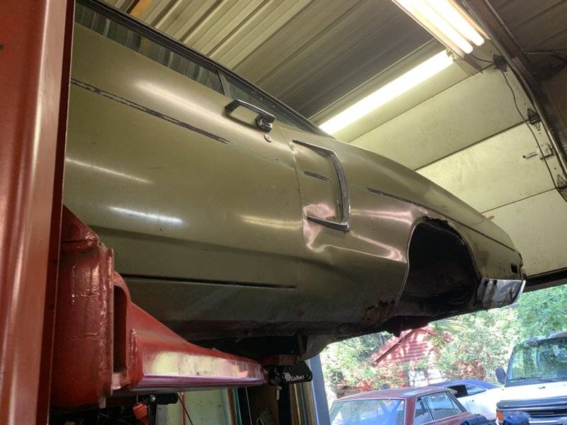

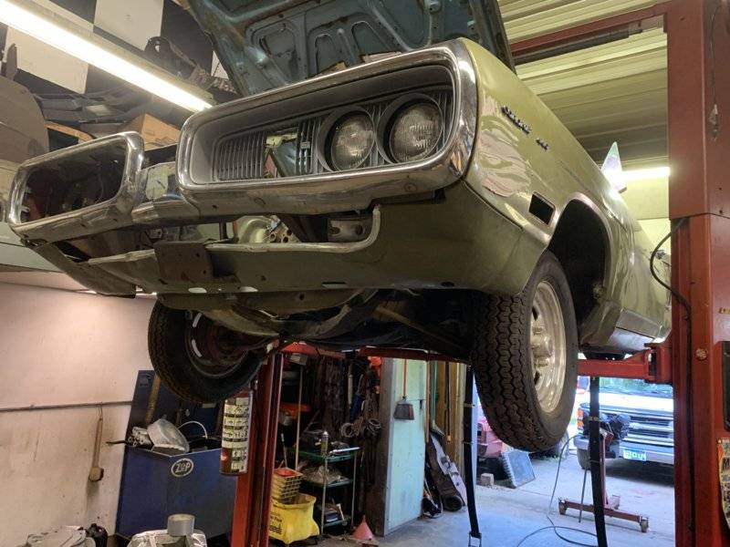

What shocks are you guys using with Superstock springs? I’m putting Caltracs and a Dana in the Coronet, but I’m putting the 8 3/4 suregrip with SuperStock springs in my Satellite.
681F4591-BD83-4DE0-8FA4-241CDC9347BA.jpeg ED9D2D67-4AFD-45F8-8823-F21CED5582F4.jpeg
If you are runnin' an automatic you can use 1976 Dodge Ramcharger rear shocks. They are longer and wont "top out" at launch. I used 'em on my '66 for years.
