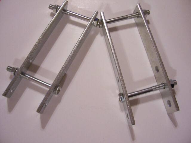

I bought some from Summit and was not happy with the leafs and would not buy them ever again. I went with Espo springs,they can give you +1 or +2 if you want the butt higher. I hope you get it figured out. Good luck. You can add a shackle kit to lift it up .
Chech the length of the shocks.... super stock springs need longer shocks... I use shocks from a 71 C body and they work well.
Do not use longer shackles if you value the car's handling.

thanks MoparBill, c body shocks as in a Chrysler 300 or Monaco? they must be longer when extended, shackle thing looks trashy and I really don't want to purchase another set of springs
