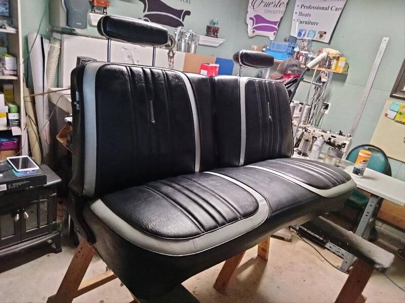

Go with Legendary , I waited just over 6 months for my 70 charger bench seat. Buy once and cry once. Expensive but worth it.

Replace the padding, it's as old as the car and no matter how good it looks, it is deteriorating. My car has the last set of Chrysler covers that were available. They were bought before I bought the car. I had the padding, foam, and burlap replaced about a year ago due to it breaking down.

Get legendary covers and new foam.

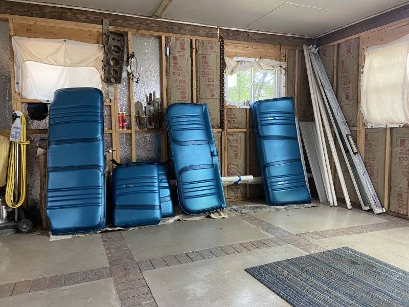

If you want to wait for it , Legendary is fine, vendors get it first, same mfr. As for the foam, I got the molded seat foam for my buckets, worked fine for the bottoms, couldn't get the covers on the backs, used my old foam on them. It's always something.

I know the feeling, you pay up front and wait. I made a 3K purchase from Legendary and it all won't be here until almost February of next year. They could at least bill you when your order is ready to ship.
