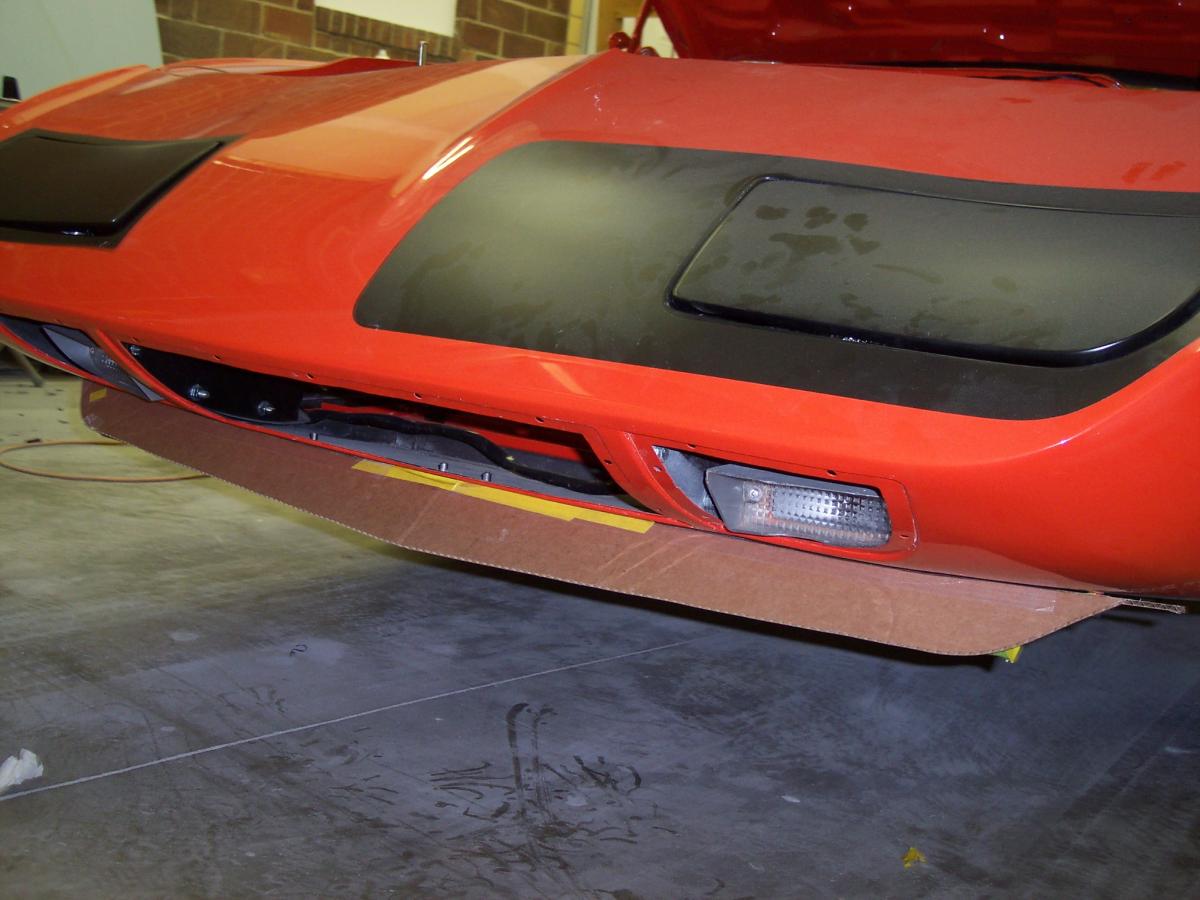

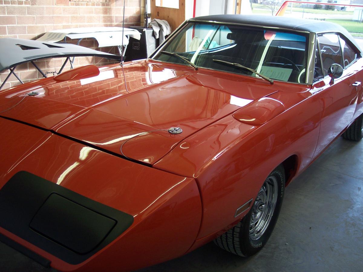

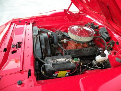

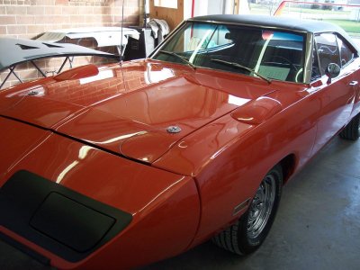

I restored one a couple years ago. What I used was Sikkens Rally Black. It's a real nice semi-gloss black. Available by the quart or in a rattle can (that actually sprays nice). I used it on the tray, the headlamp buckets, and around the headlamps before I added the decals. (I think the "grill" was also painted black, but I don't have any good pics of that on this computer.)
Excuse the dusty car and the cardboard spoiler template, here is a couple pics:

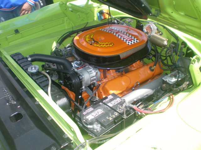

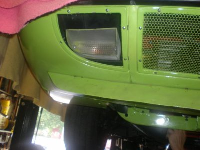

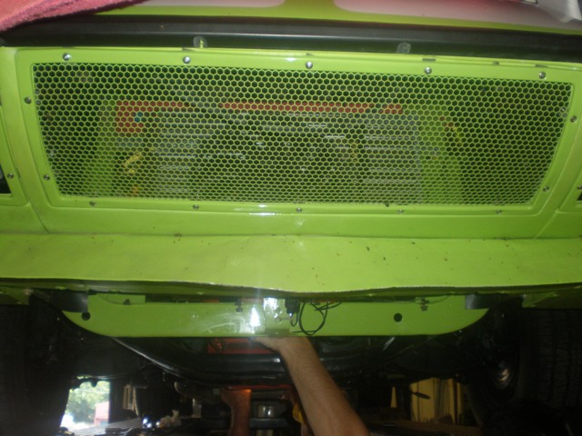

I'm coming in kind of late on this but.............. I painted my latch tray body color and it looked 100times better than black.
I'm going to make it easy and paint the whole car black!

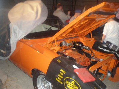

Stuart, is your car disk brakes and, is the the original style master cylinder?
Yes I added disc brakes and no that is the wrong master cyl. for disc brakes i now have the correct one and the correct proportioning value . It still had the wrong manual brakes one in the picture and i just this winter got around to getting it corrected . They work much better now ..... The correct one has a much bigger resvour . Most auto parts stores have them for around $ 20.00 . OH and i think that may have been a 69 model i had on there also as 70's the lid clips on instead of bolts on like that one did .

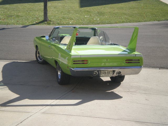

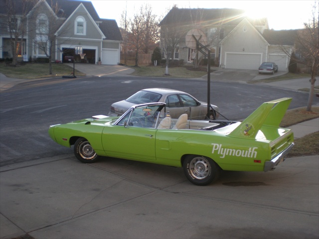

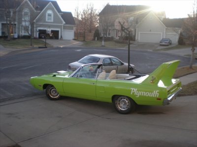

Nice! Do you have more pics you would share? I sold mine. I miss it after seeing those pics!

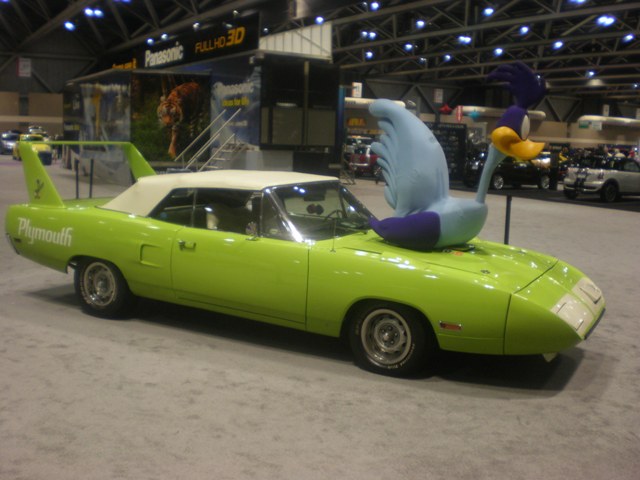

Stuart, where'd ya get that giant bird for the hood, man? I need one of those for mine!
lol its not mine its a costume time warner owns for there road runner high speed internet company. I was tryin to recreate the famous 1970 magazine air grabber ad
