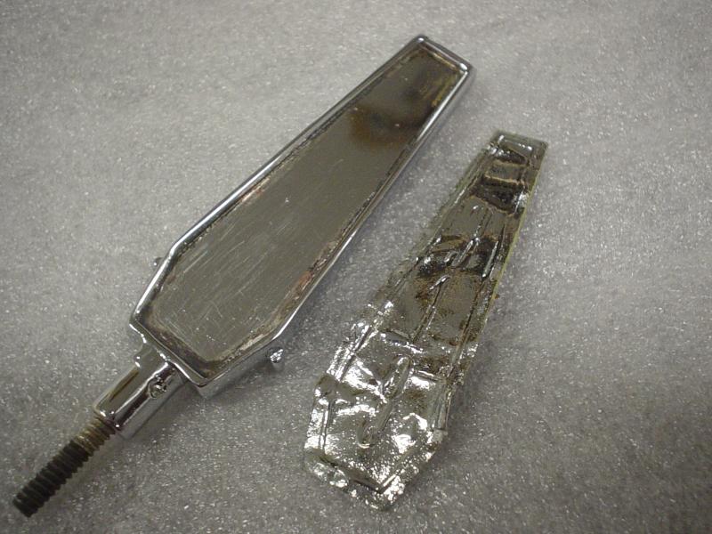

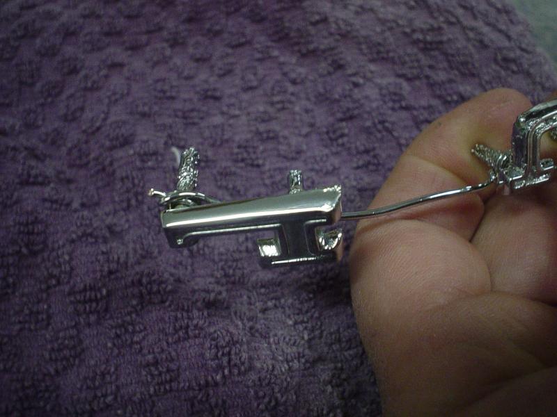

I had said I would post photos of some of the work I had done by Superior Chrome out of Houston. You can judge their quality yourself.

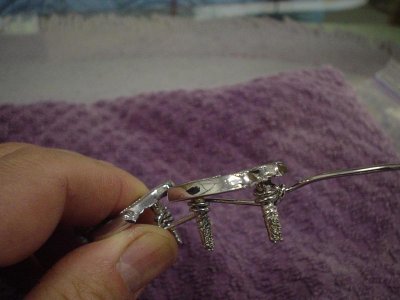

1st 2 photos show 'nodules' on the mount studs and edges of letters I had mentioned

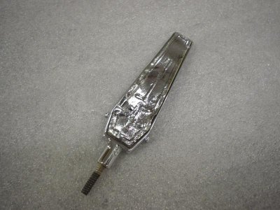

3rd photo shows the chroming right over the foil decal in the hood ornament. I had asked if I should remove it prior to sending and Bobby said it wasn't needed, that they would clean/ prep everything prior to plating.
4th photo is what it looked like under the decal once I removed it.

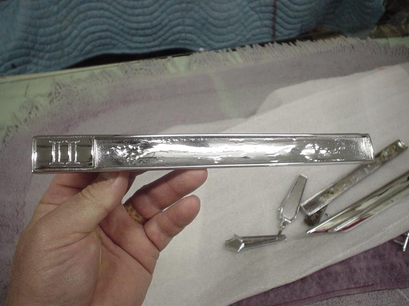

5th photo is the fender badge where the 'Belvedere' insert goes. The reason the inset area looks uneven is because they did not remove the old adhesive prior to plating. There are also 'nodules' around the 'II' area.
When I asked Bobby about what I saw as imperfections, he stated that for $700 I should not expect museum pieces, but more like 10 footer pieces. I told him if this was the kind of work his shop put out and stood behind that I would be sure and pass on to anybody who wanted to know, where I had my pot metal chroming done.

For $700, I would expect you to take 2 mnutes to remove the foil.

I have heard that pot metal can be tricky to replate...especially if it has corrosion. But I thought it would result in showing the uneven surface, so a finished piece may not look smooth. I'm no plater', but wonder if the 'nodules' are a result of the parts not being properly cleaned...being left in too long...not grounded well enough (the wire attaching the letters together had a great finish to it!)...or if the chemical tanks were dirty? All of these possibilities were posed to Bobby and he did not say 'Yay or 'Nay to any of them...just that for what I paid I wasn't getting 'museum pieces'. What is a museum piece anyway?
One thing was proven, anything CAN BE plated! Decals...dirt...old adhesive...painted surfaces...
