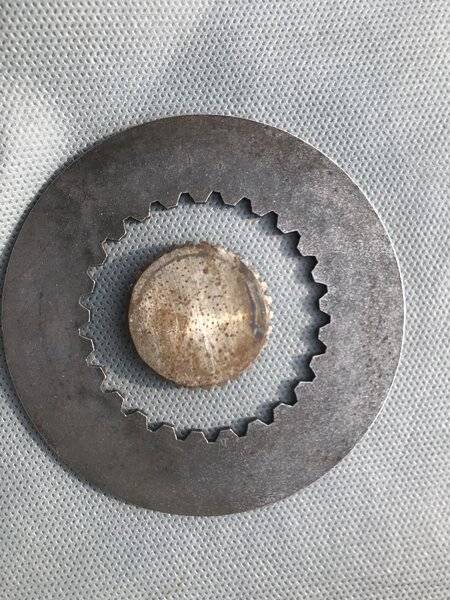

Ok bought a kit from Mancini wow how wrong this one is. It says it’s for an 8.75 sure grip. The part number I bought was MRE 4529484. This is very odd.the first set I bought was even larger. So here is a picture of the kit and in the middle is the actual axle size. Wtf look it up on summit and it shows the same kit but the number starts with P instead of the MRE. So I do t know what damn parts to order.
Sorry for a bad photo, this is a correct 8 3/4 disc.

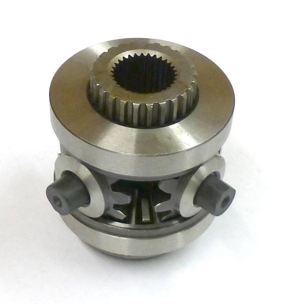

the first kit you bought was for a Dana 60 the kit you bought from Mancini is the correct kit -- the plate you show fits over the clutch hub/side gear NOT the axle shaft look at picture in previous post ,,when you do get to assembly make sure you orient the clutch plates correctly
OK ill tear it apart tonight. That was confusing to me. I'm a sure grip virgin so be easy on me. lol I thought the splines were for the axle I see what you guys are saying now.
