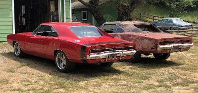

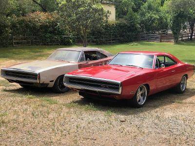

Hey.....Ripon, CA ?
If so, I'm not too far north of you.....right near Folsom lake. That is where these pictures were taken:
Good to hear from another B body owner.
Depending on your expectations, your plan sounds solid. I have the Bilstein shocks and am happy with them. I had KYBs before so almost anything was a step up. I went for the more aggressive handling/braking/road course type route with the red car. BIG torsion bars and sway bars, wide tires and a 5 speed. The ugly car is being built as a 3/4 scale version with a smaller engine, softer torsion bars and sway bars, smaller tires, etc.

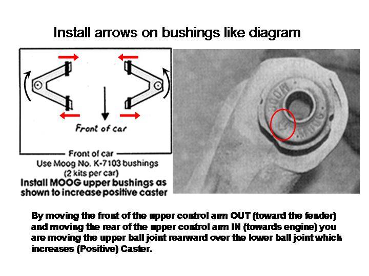

The uppers in both cars are stock but with Moog # K7103 offset bushings:

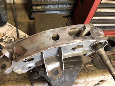

The lowers on both cars have reinforcement plates like so....

Are the Moog # K7103 offset bushings similar to the Problem Solver bushings that Firm Feel sells?
Exactly the same.... There have been issues with Moog lower bushings not fitting properly the last few years but their problem solver uppers are the way to go...
Probably the same. Check the part # to confirm. They allowed me to get 4.5 degrees of caster from stock control arms. I seem to be the outlier though since not many others have been able to get the same numbers. Maybe my alignment guy lied? You know, like when MOM says that you are the best looking boy in the whole wide world...?

Oh, and I've gotten every bit of 4+ on a number of cars..
Awesome thank you. I ordered those with everything else initially so glad I did.
I'm not??? :lol:
Frequently, I hear from people that claim that they could only get 1.5 to 2 degrees even with the Moog bushings.
Bad tolerance stack up?

Possibly... Could be an alignment guy who doesn't know these cars too.... Before I found the guy I've used for 20+ years I would drop the car off at the local tire store, tell the guy what I want & when I come back I'd get a car set by the book... I want to see the front adjusters all the way out or damn close to it... I want to see the rears close to all the way in... You need to tweak them so to get the camber right but to get the max caster those adjusters are gonna be in close to max position..
