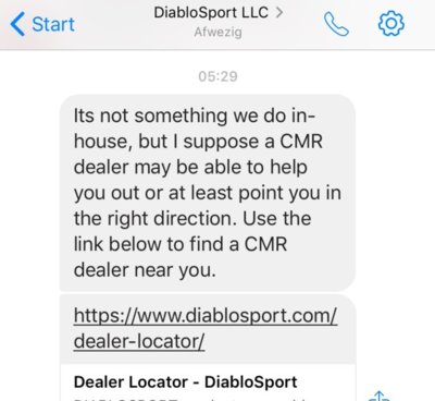

Diablosports doesn't do these things. Any other options?
They are not telling you their software can't do it, they are simply referring you to their network of authorized dealers. The dealers actually supply the tunes so check with a dealer and see if they can tell you.
