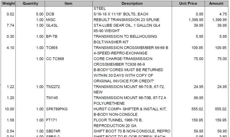

Brewer's also sells the collars for your steering column to remove the shift mechanism for the shifter and cover it like floor shift models were. I just bought all the parts to convert my Charger to 4spd from them. I will try to cut and paste the parts list into here. The quote was a PDF, so I can't find a clean way to copy it over, so I had to copy sections at a time into a word document and try to reformat them. Bear with me if it looks a little funky when it posts. There are options for certain things listed in the first price column. Only the ones chosen show a price in the far right price column.
Please remember that this list is for the conversion on a big block. Your smallblock will have different parts. This is just to give you a list to give you an idea of parts needed, and approximate price. Get with Brewer's performance to get a quote of your own, and your own parts list.

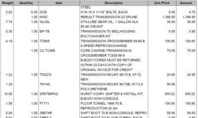

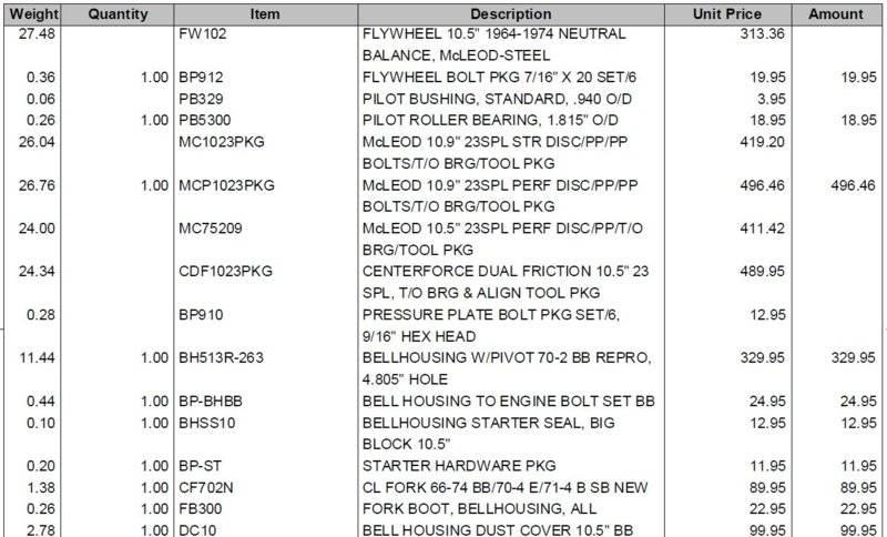

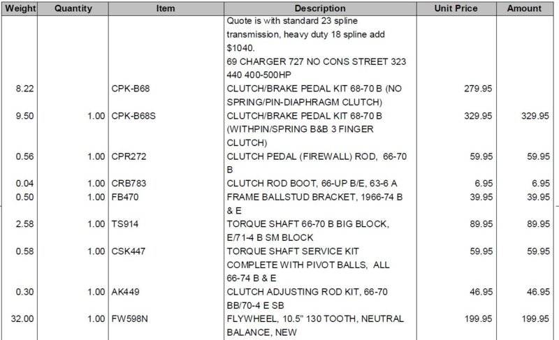

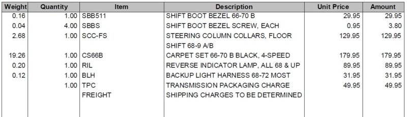

Yeah,... It lost the spacing and alignment, but I thing it is still clear enough to get an idea of what all is needed. Keep in mind that if there are two prices listed, the second one indicates it was the chosen option for like items. For example,... if there are multiple clutch kits, the one with two prices is the one that was chosen.
This might be easier to follow, plus you can save the images for reference. (Click on the pictures for a better view)

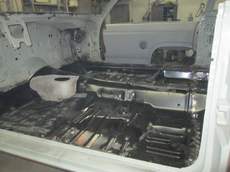

You could weld the 4 speed bump in place now and then cut out the tunnel area behind it when you're changing transmission. Just make sure someone is watching for fire underneath during the weld!
