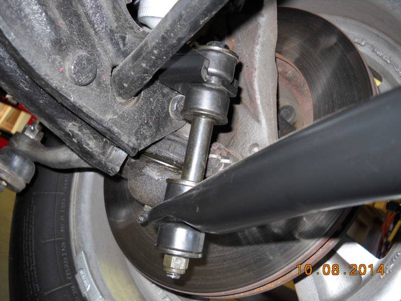

Firm Feel sway bar with 'L' mounts that Zack was talking about ^^^^^^^^^^^

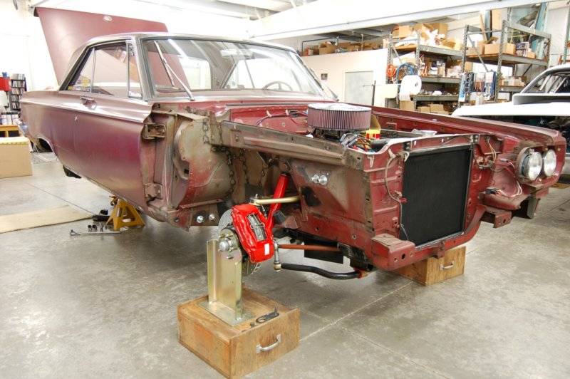

On the early B body cars the anti-sway bar end links clamped to the strut rods. I think I have an original bar with all of the mounting brackets stashed up in my storage area. It is rare to find those early B body bars, I haven't seen many cars with them installed. I did a heavy duty version of the factory setup on my '65 Coronet. I bent up a big bar from chrome moly tubing and then clamped the ends to the strut rods just like the factory did.
