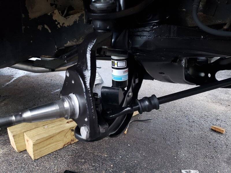

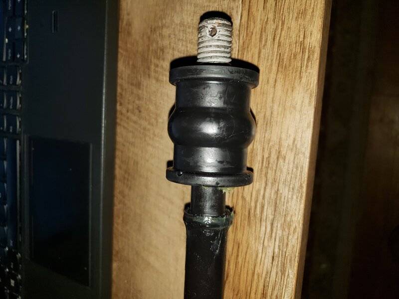

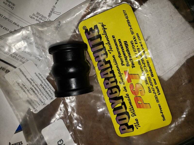

Hey guy's I'm looking for a trick to install these Polygraphite bushings that sit on the strut rod for the front sway bar to attach to. They are solid as in not split and as hard as a rock. They need to be slid over a ridge and all the way down the strut rod. All I can say is if somone has been able to do this please tell me how lol it seems impossible and the instructions don't even mention this bushing.
Put them in some boiling water for a few minuets and lube the strut rod real good. Wear good gloves the bushing will be hot but it will slip on.
