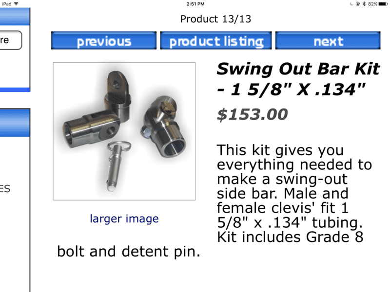

Theres 2 types.
Spend the extra money on the clevis type.
The ends drop into your existing bar and then weld.
I dont like the tab style.

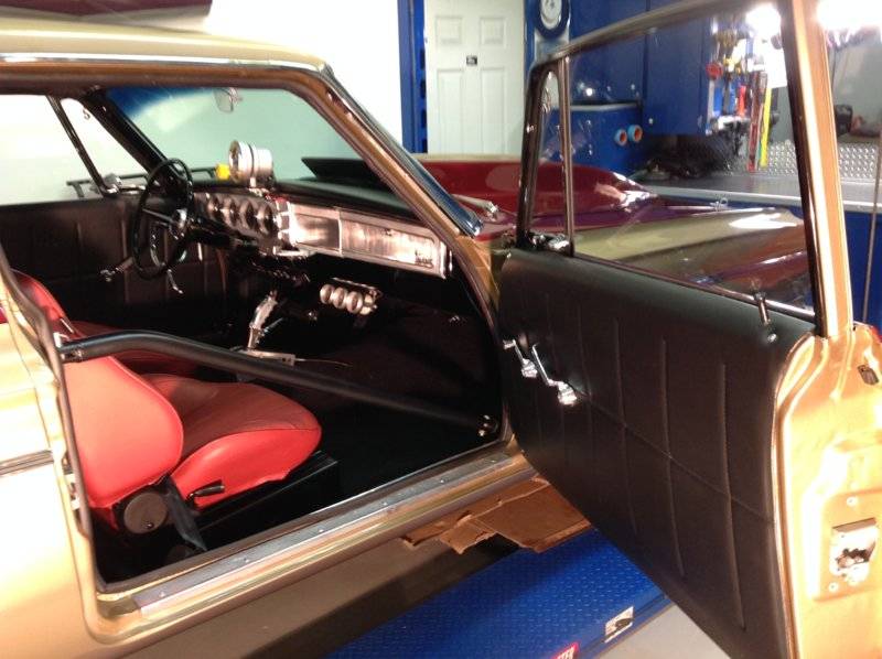

I used the Clevis type when I built my roll bar. A few pictures.
These are from Bear's Performance. I put them on both sides. The passenger's side rarely gets used though so I doubt I would install on the right side again.
In this picture I unbolted it with one bolt. For those times a guy doesn't need it or are getting in and out lots.
Both sides are the same, zero restriction.
Those are the ones I would recommend as well.
Malex got the best ones imo.
