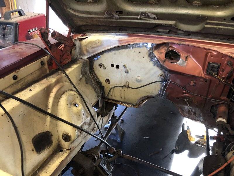

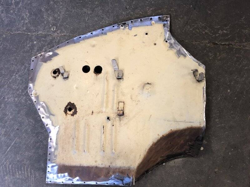

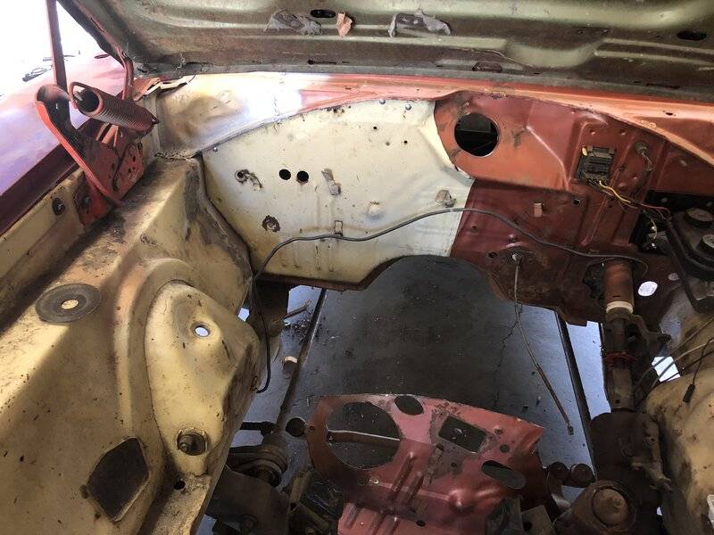

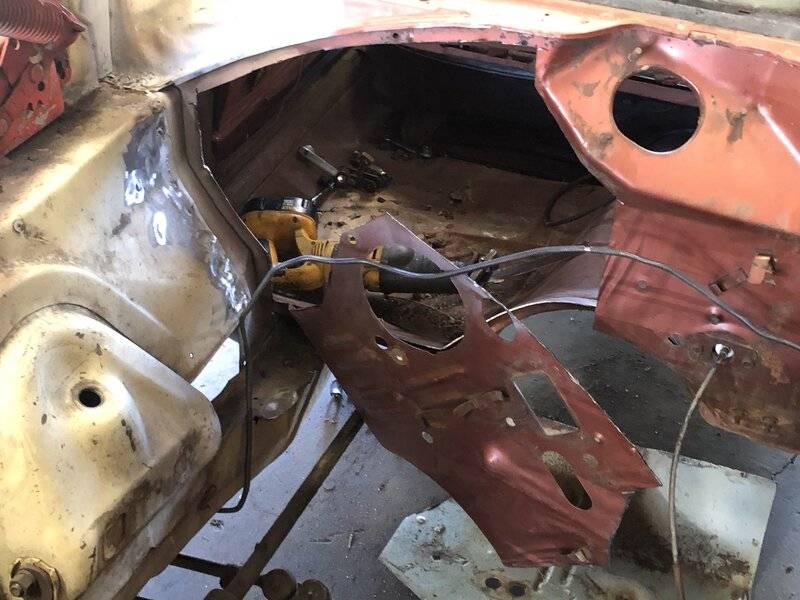

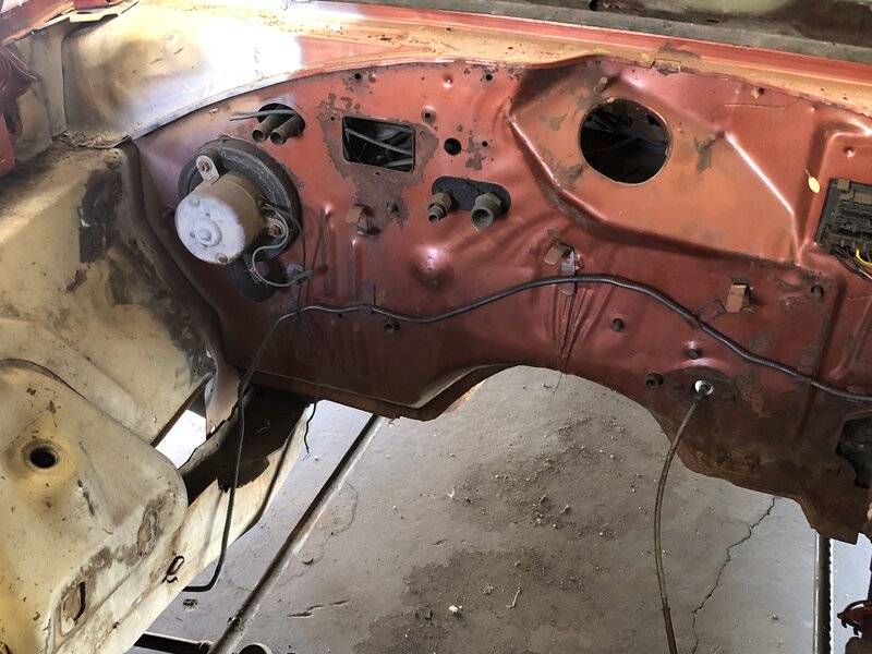

Hi. 1966 Coronet. Will a non air heater box bolt on where the old AC box was ,and if not, what modifications are necessary. Thanks in advance.
The firewall is different. You can patch in a section of a NON A/C firewall like I did:

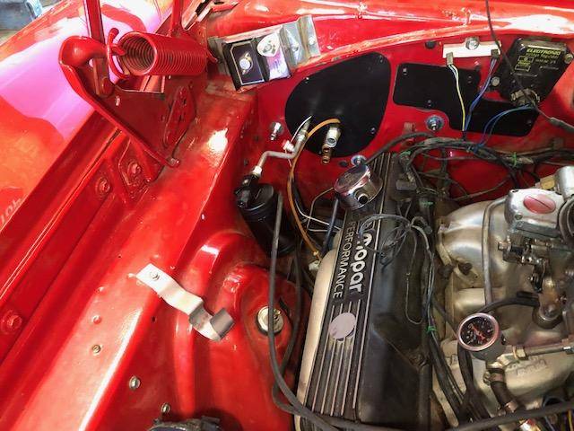

OR you can make block off covers for the holes you won't need, like the aftermarket A/C companies do:
