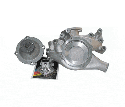

Now that I am older and less tolerant, A/C makes more sense than ever. I have to change the water pump housing to work with the new radiator. I want to use an aluminum water pump housing but would like a recommendation on which one to use. 440 Source has a kit, Mancini Racing does too. Summit racing probably does as well.
Which one do you suggest?

I'm having a "fuzzy memory" on this.....Wasn't there a few reports of the 440 Source housings having fitment problems?
Ya I believe they were still
Useable though, a while back they were dumping them for $19.95. I tried to buy one the next day they were sold out.
I can just tell you from my experience installing it everything fit perfect. I also got their billet neck and everything looks and fits great.
They had smaller passages than stock but I believe the issue was actually the cast vane style pump used.

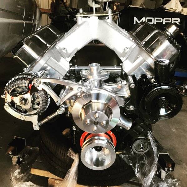

Hell I dressed my whole front of the engine with 440 source pulleys, alternator bracket, pump and housing, water neck, billet valley pan hold down rails.
I would stay away from the complete kit Kern. The pump is junk. IMO, go with the 440 Source housing and the pump from Flowkooler. I installed on in my 440 and the results were extraordinary. With AC, the last thing you want is overheating issues.

I will NEVER use a stock type pump again after installing that Flowkooler. I was having overheating problems in the southern heat. I installed that pump with an Aluminum radiator and my car barely reaches 180 degrees. I swear by them. When you look at the impeller you can just tell it's badass. Worth the $115.00.

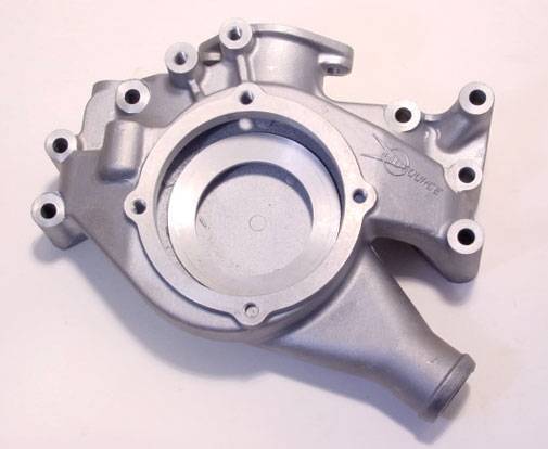

I'm having issues with cooling myself, I presently have the Flowcooler pump and a 440 Source housing. I'm beginning to think the housing is restricting the flow. I took a stock housing and another 440 Source housing I had laying around and did some comparisons, Granted it is almost impossible to see all the passages but from what I can see there is a difference with the stock housing being larger.
I read on one of the forums not too long ago that the 440 Source housings were a problem.

I use the stock housing, and I no longer have overheating problems. The aluminum radiator with electric fan helped as well.

I have used the Mopar performance aluminum housing and pump and had no problems, but the pump just uses the stamped steel impeller part like a stock pump, but the shaft looks pretty heavy duty?

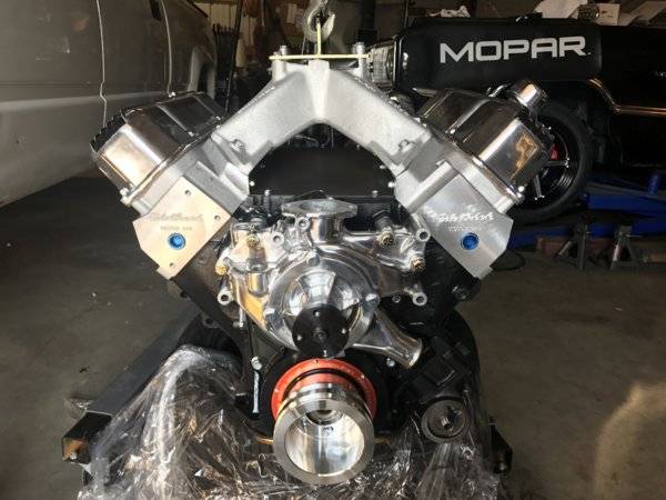

I also used a PRW pump housing with no issues. It looks like the ones 440 source sells? On that one, I did check and port the openings, and also checked the pump to housing clearance as I had the Fel-pro gaskets and the gaskets that came with the pump and they are different thickness. That kit used the cast swirl vane impeller.
