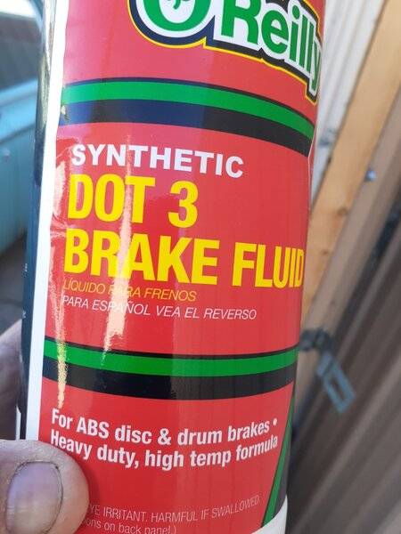

Is it ok to use synthetic brake DOT 3 brake fluid in my '63 Dodge 330? I know silicone is bad, but what about synthetic?
DOT 5 is silicone fluid. It does not mix with conventional fluid. It is a pain in the neck to use and I don't think it is used much any more-maybe in show cars that don't get driven much?
DOT 5.1 is conventional fluid and will mix with 3 or 4.
I'm using DOT 5 in my 73.
My master cylinder is still painted black and my firewall/cowl and inner fenders are still body color.
It was a little on the expensive side and I was already installing an new M/C, calipers, wheel cylinders, and front lines. The rears were just blown out and then brake-kleen-ed.
So far, just a tad bit more pressure (power) and the pedal presses down a bit more.
All dot3 is now marketed synthetic dot 3
